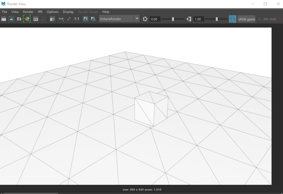

So today i wanted to give a try for octane and bought subscription. But i already run over a problem and didn't find any solution. After applying materials on object and rendering them, they show up white with wireframe mode.
First of all i'm new to the octane and secondly i recently came from blender to maya, please no offensive :D
i attached a screenshot

In general, OctaneRender has several different Kernel types, it seems that you are rendering in InfoChannel/Wireframe mode.
Please, have a look at the documentation:
Kernels
