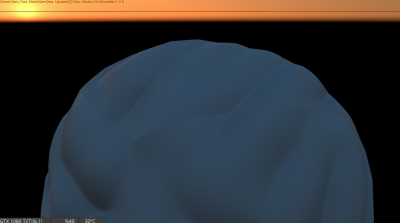

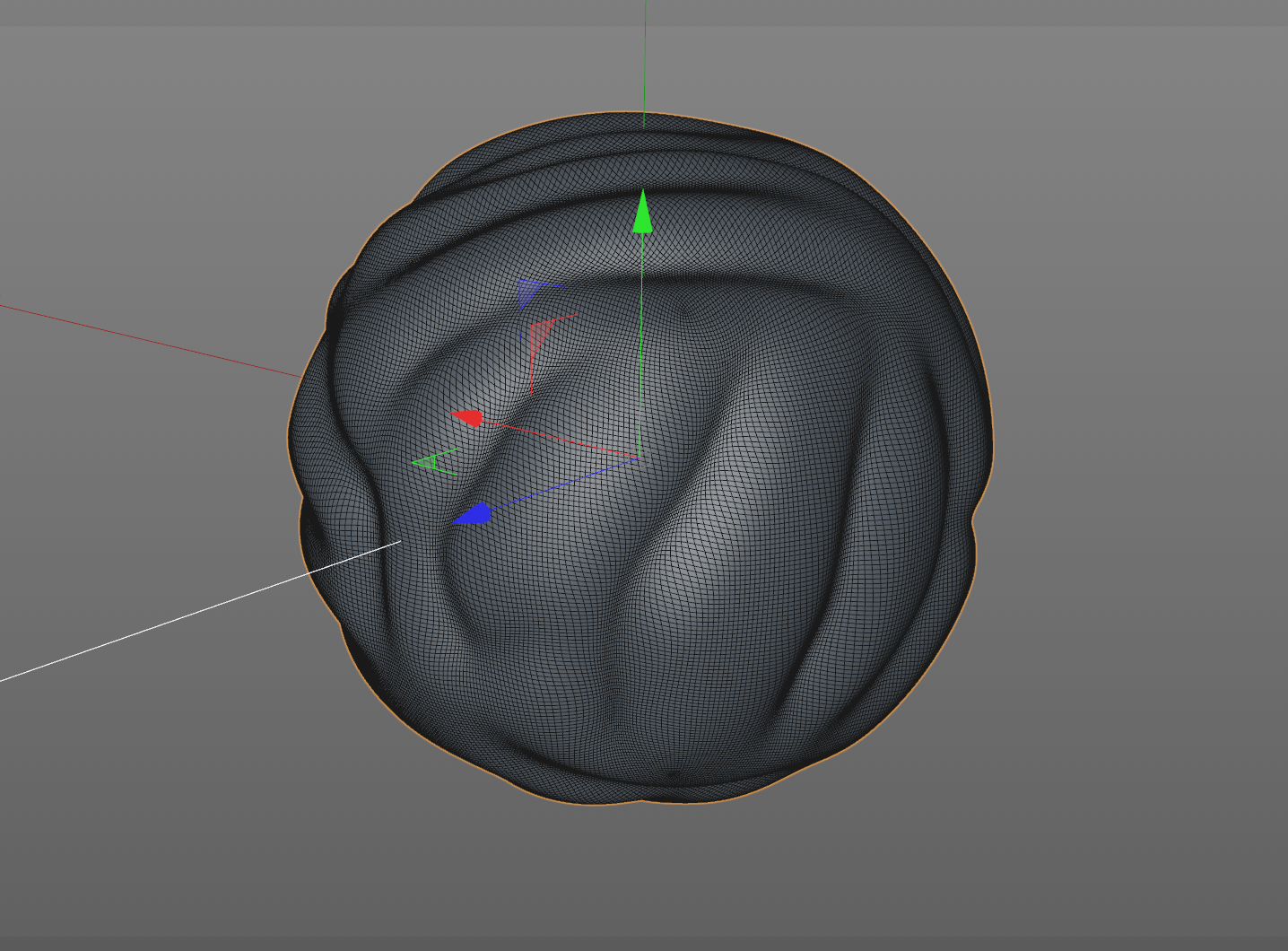

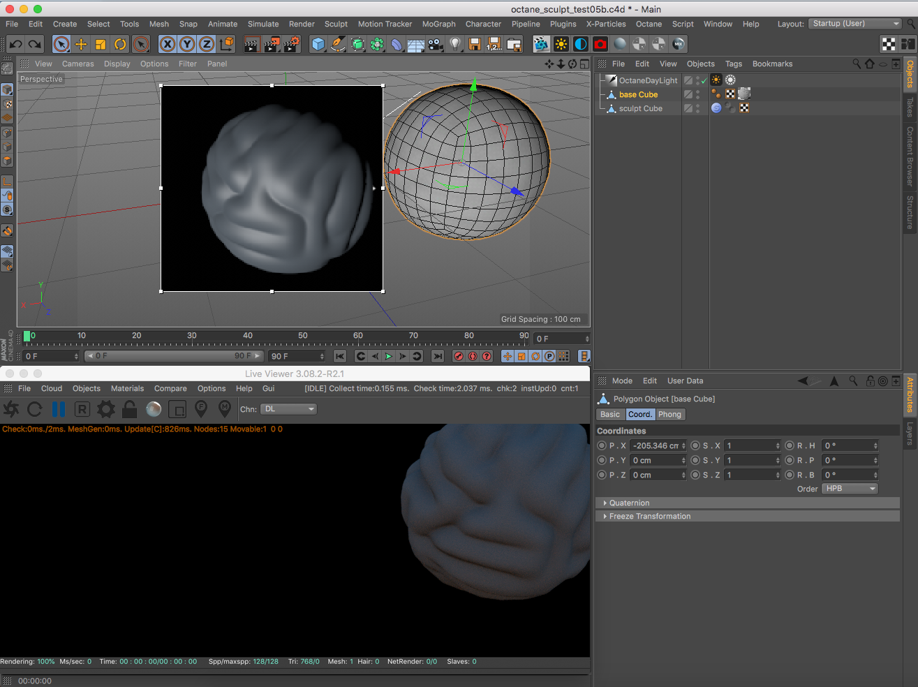

I've attached an example file. A simple sculpted cube test with 4k displacement and normal maps.

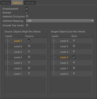

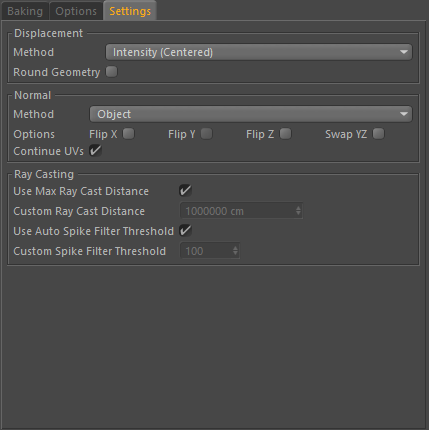

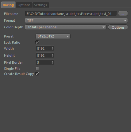

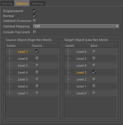

Cube is correctly UV'd. Sculpt cube subdivided to 7 ande baked down to a base mesh of 3. Bake settings attached.
As you'll see, geometric artefacts occur around the sculpt and where the cube UV joins are.
I've played with the displace and normal settings, changing follow geometirc and vertexs normals. Taking UV power to 0.5 seems to help somewhat. But nothing get me near a desired result as one sees in the C4D material displace.
Any help much appreciated

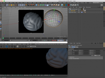

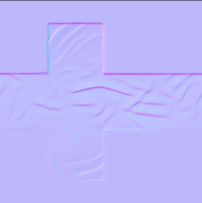

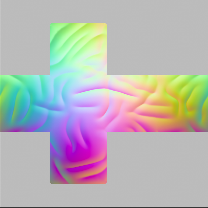

the issue is in the way is calculated the normal map:
after roughly change it in Photoshop:
the issue is almost gone:
Please, try to calculate the normal map in tangent mode, with purple background.
Here is the modified scene:
octane_sculpt_test05b.zip
ciao Beppe

Posts: 10623
unfortunately the bevel comes out if you directly transform the c4d normal in normal map in Photoshop.
To minimize the effect, I have colored the gray part into R=50, G=50, B=100, before applying the Normal map filter.
If you recalculate the Normal map in purple mode in c4d, it should be more easy, and you should need to change only the gray background.
ciao Beppe

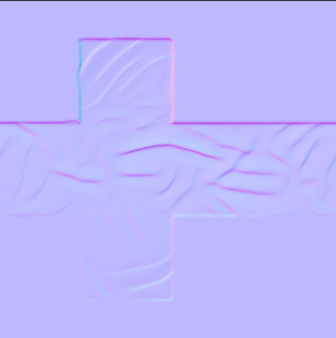

Hey Beppe,

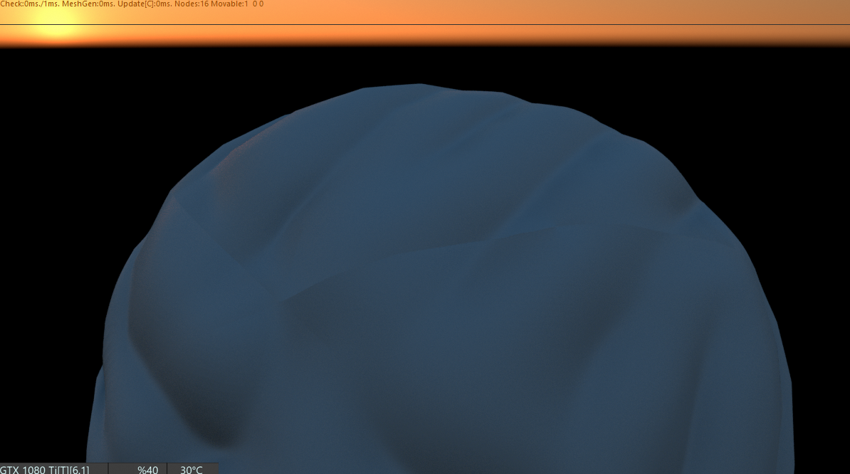

I recalculated the normal map in Tangent mode. I then turned the colour surrounding the normals to the same purple as in your map: 128,128,255
The result is better, but I get a hard edge there the cube UVs touch. Please see the attached render image.
What's the best way to avoid this hard edge?
Thanks so much for your help.
