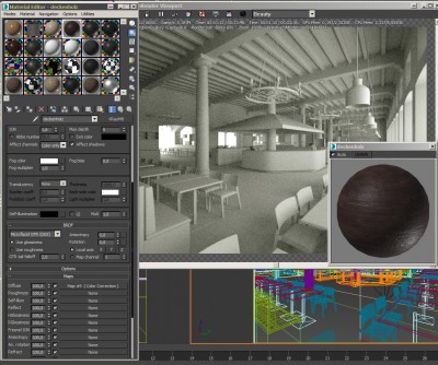

I am still working in V2;
When opening a file from October 2017, using the latest version of octane-3dsmax plugin, released May 2016,
materials render fine in editor, but in the render window there is white only.
If it was an file-plugin-incompatibility issue, materials would render white, too, right?
any idea why there is only white in the render?
White render
- kcpr-raffaEl
- Posts: 132
- Joined: Thu Aug 14, 2014 12:10 pm
- Contact:
On your image looks like you've got VRay materials instead of OCTANE.
Am I right?
You can try to convert them automatically using OCTANE Tools in Rendering Settings.
Am I right?
