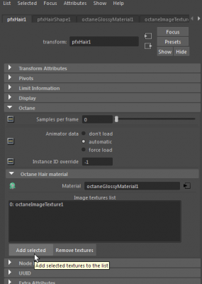

Hi, I have a character with nhair and Im trying to texture the hair with the same color as the base geometry, to do this I am trying to connect a uv proyection in the image texture node of the shader, but nothing happens, the hair get a random color, like a box proyection or something, also when I connect the "octaneImageTexture" node to the image texture list in the pxhair1 the hair render brown, without any texture color, your help would be much appreciated :)

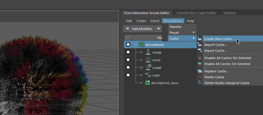

- If you are using the new Maya beta plugin, better to workaround the terrible hair plugin implementation:
you should use Xgen interactive, then cache hair to alembic then import the ABC in an "ORBX proxy" node in Maya,
then you would have correct hair UVs to use with Octane textures.

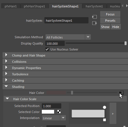

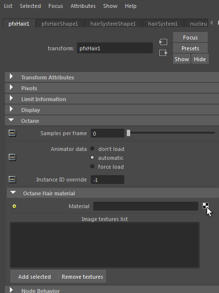

Add a Maya texture in the nHairSystem shading color.
Then you should see in viewport the texture coloring the opengl hairs,

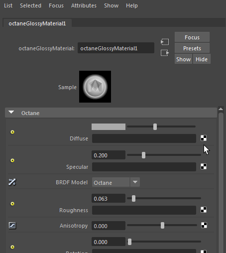

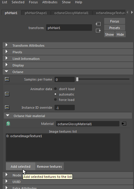

In the pfxHair transform create an Octane Material.

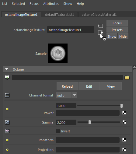

In the diffuse (or other attribute color) create an octaneImageTexture.
Leave the file path empty (this empty node will used by the plugin to bake the Maya colors) and clic 2 times on the little arrow icon to go back to the pfxHair transform tab.
As the newly created ImageTexture node is still selected , clic on "add selected" button.
That's it.

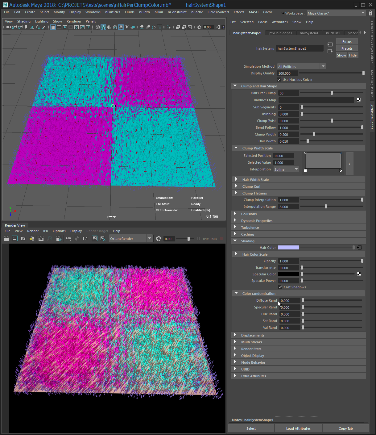

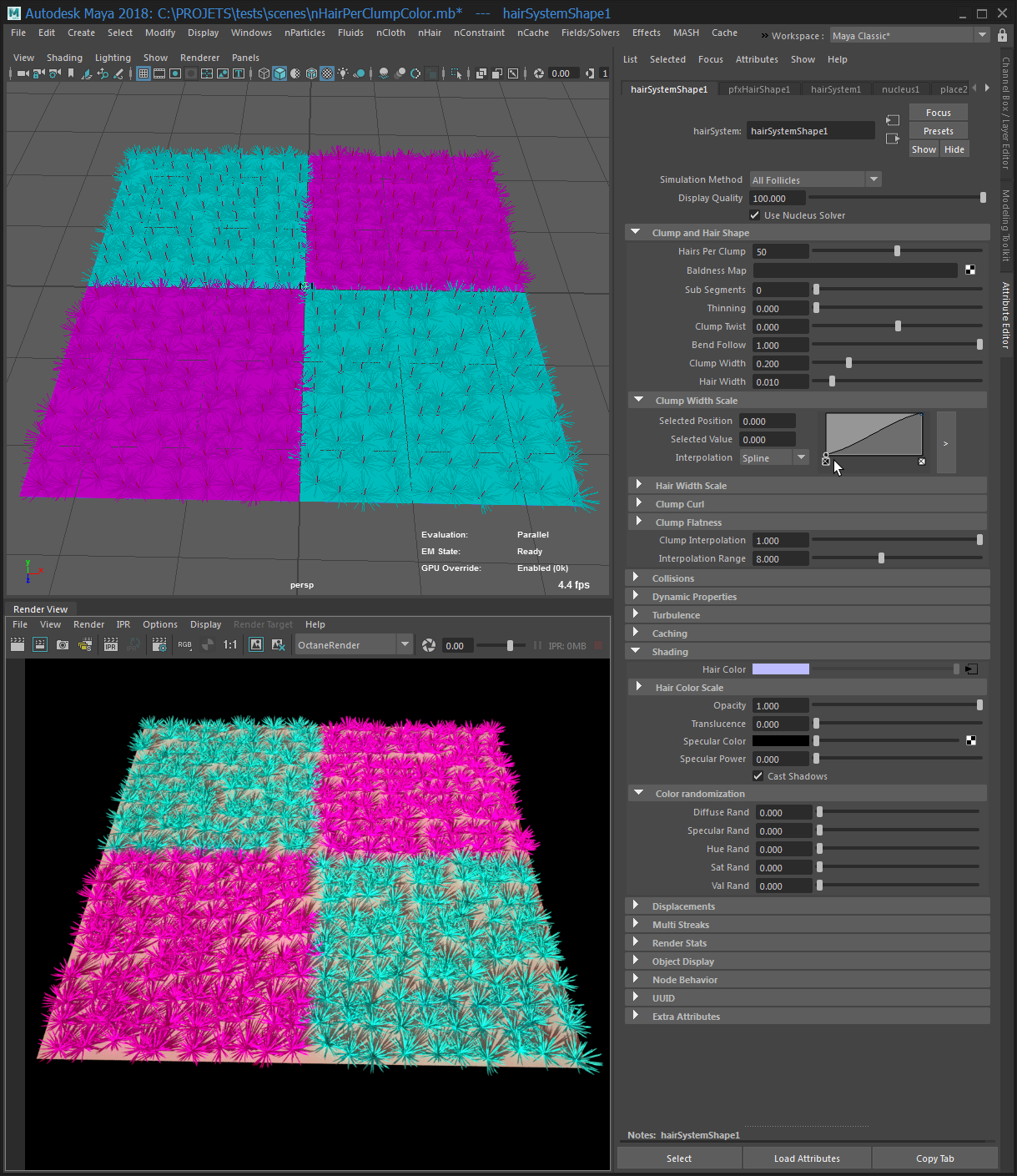

BK wrote: Actually, Octane for Maya support Maya's nhair Color Randomization and Diffuse Rand has some value by default. You can try changing it to '0" then it should fix the 1 hair per clump.
No sadly this issue have nothing to do with color randomization :
Maya doesn't sample the color texture per hair but per follicle, so only the hair at the center of a clump are sure to get the correct color...
Also in your movie this only works because you use a particular case : a 1x1 plane,
but this won't work with any other mesh (just try with a torus for example).
Let me make the issue more obvious in this sample scene with a 20x20 plane :
nHairPerClumpColor.zip
(73.14 KiB) Downloaded 274 times
Color randomization is zero but as you can see hair colors doesn't match the underlying mesh texture UV ....
Now if I scale the clump base to zero (so all hairs have there origin at the center of the clump) I get a perfect match, but obviously this is not a solution.
To be clear, this workflow never works for real life use-case,
the arbitrary Hair UVs make nHair/pfx useless with Octane4maya, when correct texturing is needed.

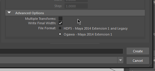

Also as I explained in a previous post, Xgen-interactiv is already supported in the new Maya plugin trough the ORBXproxy node.
Workflow is : Xgen-interactiv > export builtin cache to alembic >create ORBXproxy node > import the ABC cache file and setup material in the ORBXproxy UI > render (much simpler workflow !)
The Maya caching feature for Xgen-interactiv ( alembic curves with correct UV and widths ) makes a way better job than the Octane4Maya plugin with pfx/nHair.
