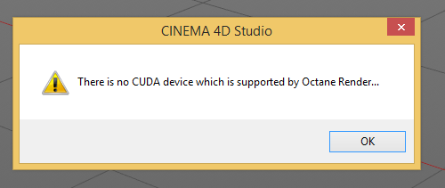

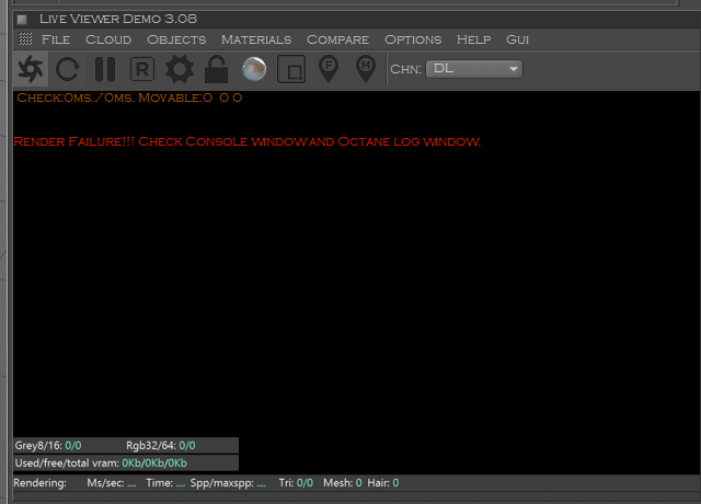

Today I downloaded and installed the demoversion of Octane render for C4D. But when I try to render a scene in C4D I got two error messages.
Please see attached images.
I installed the latest drivers. I have a NVidia Quadro K4200 grapihics card. Also installed CUDA 9.2.
Who knows ho to solve this problem ?

K4200 is supported and scores ~34 in OctaneBench:
https://render.otoy.com/octanebench/sum ... adro+K4200
Please try to perform a clean installation of a orevious version of Quadro drivers that supports CUDA 9.1.
