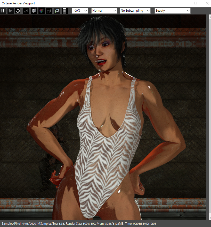

V3.08 Screen Shot, Becuase save fuction dose not work.

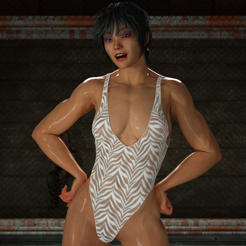

V3.07 Rendering
V3.07 Rendering
I meet wrong rendering result and error by V3.08.
Show result sample.
Those picture has same setting, it user redspec SSS with V4 Figure.
I meet following trouble.
1. Wrong rendering result.
2. Dose not save rendering result by save function, this picture is clip from screen shot.
How to solve this prob rem ?

This is due to having a Greyscale Color node plugged into the Normal pin, set to 0. You need to disconnect 0 value Greyscale Color nodes from Normal pins.

In the OctaneRender for Poser plugin, select the material->select the Normal pin->if it is set to Greyscale Color select a new node type of "Disconnect".
