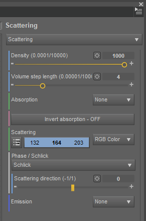

Here's an image. You can see Density says it has an upper bound of 10000, but the slider all the way to the right only goes to 1000.

Some sliders are limited to those ranges of values that are most useful for the specific variable.
If a wider range is possible you can always enter numberic values manually by:
- clicking on the number entry field with the mouse
- enter any number in the possible range with the keyboard
- click enter on the keyboard
-> now the preview screen should update

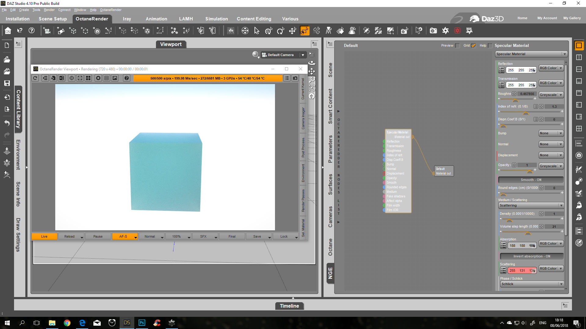

Density 0.1
Density 0.1

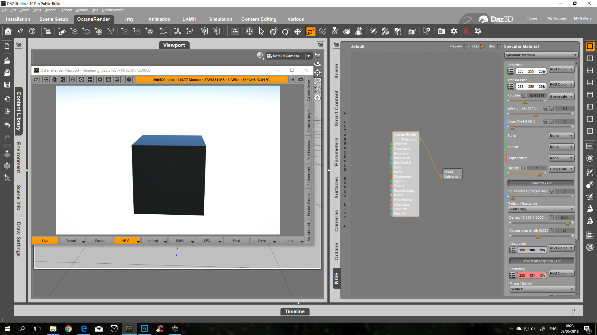

Density 1
Density 1

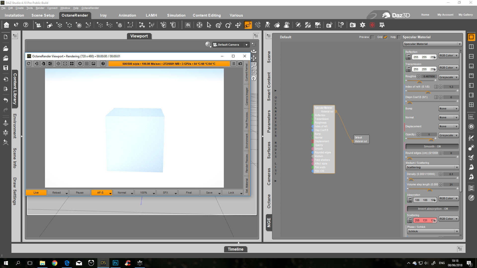

Density 100
Density 100
