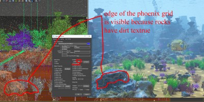

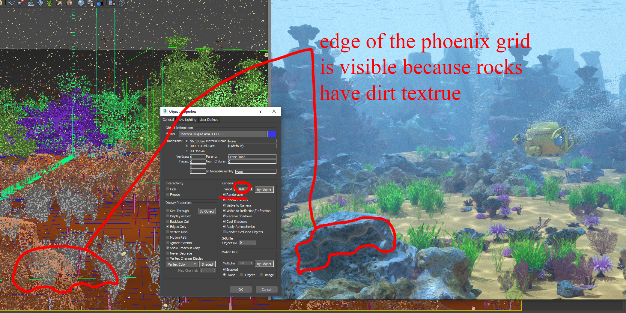

UPDATE:
I remember now that I had a similar problem before. The only solution was to check renderable and set visibility to 0. I guess when I uncheck renderable liquid mesh does not get loaded and bubbles do not move right or stationary? The problem I am having now is invisible liquid mesh is leaving dirt mark because of the rock's dirt texture and if I dont use alpha shadows ther ewill be a black shadow from phoenix grid. ANy fix for this?
Also not exporting liquid and just foam in phoenix messes up the bubble movement as well
Not sure why bubbles cannot update when phoenix is set to unrenderable. is it octane or phoenix fault?
