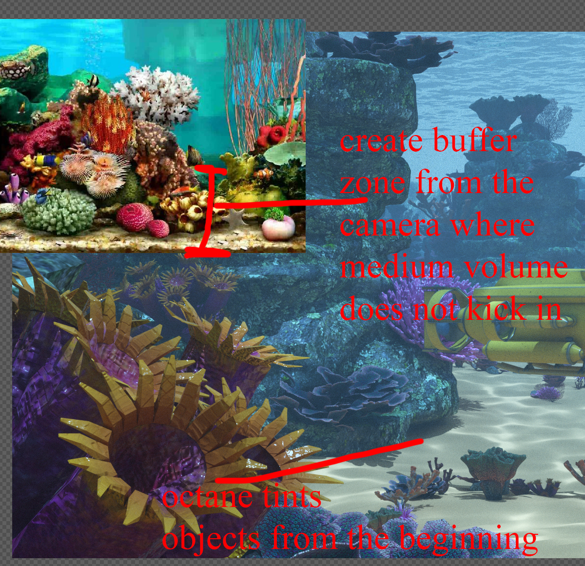

Thanks a lot for explaining!
By the way anyway to have this added in the future, From the camera to whatever distance you choose like a buffer zone where medium volume wont kick in so upclose objects look nice and rich without changing there color by the medium volume. I know you can add a sphere around the camera but then there is a sharp line where you can see the beginning of the fog. Like in fining nemo upfront objects were very nice and colorful and had no color change and about 20-30 feet after fog started
Posts: 10619
the Environment medium offers you ‘simple’ fog/god rays effect, for more detailed effects, better to use a Volume with ramp, to differently attenuate scatteting and absorption where you want.
ciao Beppe

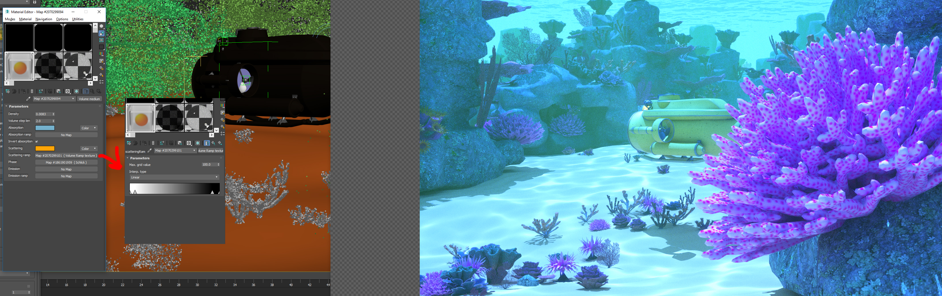

By the way do I need to add anything else I am trying to make foreground without scatter but the ramp does not do anything
coilbook
Posts: 3171
It seems that volume with ramp does nothing. is it not working?

coilbook wrote:It seems that volume with ramp does nothing. is it not working?
Make sure that the Max grid value is accurate. If it is too big, then the ramp will only affect a very small portion of the density spectrum.
coilbook
Posts: 3171
Hi I am not using any VDB. Just octane sun with volume medium added. Will scattering ramp even work with it, And how do I know what value I need? Thanks
haze
Posts: 1003
Joined: Sun Feb 08, 2015 8:57 pm
coilbook wrote:
OK I understand. Volume medium has some extra settings which are actually only used with Volumes, so if you attach a volume medium to your environment, then the step length and ramps are not used. Same for the step length in the scattering medium and absorption medium.
To come back to the original question, I think there are 3 options for achieving the effect you are looking for:
1. Increase the scale of the scene in the direction away from the camera, so that the absorption effect seems to start beyond the point you want, or
2. Create a custom sphere around the area with a medium that you want to have attenuated light
3. Create a VDB with the shape you want, with densities lower at the edges, then use the ramps to change how it behaves near the edges where densities are lower
I would try option 1 and experiment with the Medium radius in the environment, before trying the other options.
