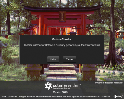

And even then when you are online, if you want to launch 2 octane fast after each other it also gives an license error. I do not understand why because that computer has already been authorized.
(This is very annoying when batch rendering two jobs at the same time on the same computer (I do this when the rendertime is less then the loading/compilling time)).

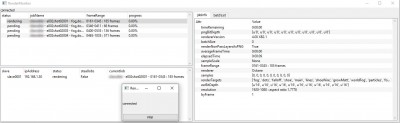

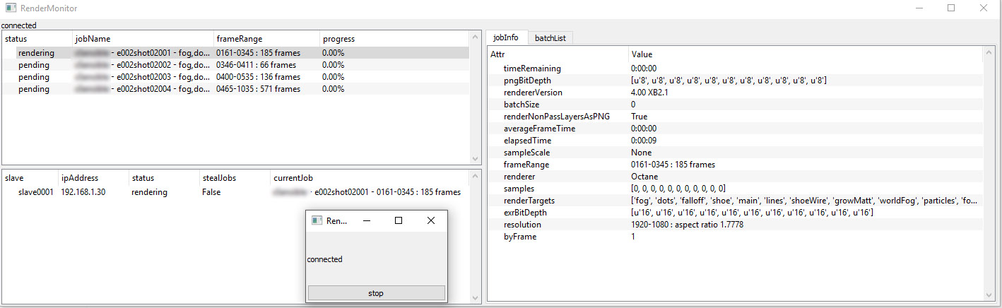

Our proprietary render dispatcher is build in python to run standalone, but in the end it just starts octane on the specified slave PC's with the following command parameters "--stop-after-script" and "--script" pointing to an on the fly generated lua script to start the rendering process inside octane. We only run 2 slave units on a render PC when the loading times are substantially higher than the per frame render times. And even then the chance that 2 octane jobs start simultaneously is small, but is has happened that one instance stopped due to this error massage and since our batch job doesn't finish until octane exists, we had 1 of the 2 slaves idle for a whole weekend, which is not desirable when chased by deadlines ;)
This problem is not specific to our render dispatcher, as the problem arises as well when you start two octane instances at the same time ( by clicking the app icon quickly after each other ;) )
This even happens when octane has run just before and thus the PC has been authenticated only minutes before.
I attached a screengrab of our renderDispatcher ( just for fun ) and one of the error message.

I suppose it depends on SDK and not on plugins, so you should post this issue in Octane standalone 3.08.01 topic.
viewtopic.php?f=24&t=67352
