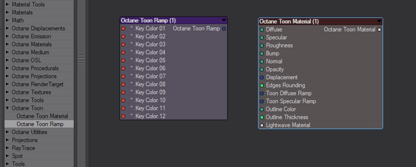

The toon material and ramp nodes have its own group in the node editor, as you can see in the attached image. If you can see them, probably the problem is that you have not added the new 3.08 plugin build to your layout, or you had the Octane master plugin available in the masters plugins window when you added it.
I'm not sure about your second question. Be aware that in the IPR you need to reload the scene after changing the smooth surface parameter ... perhaps this was you problem.
