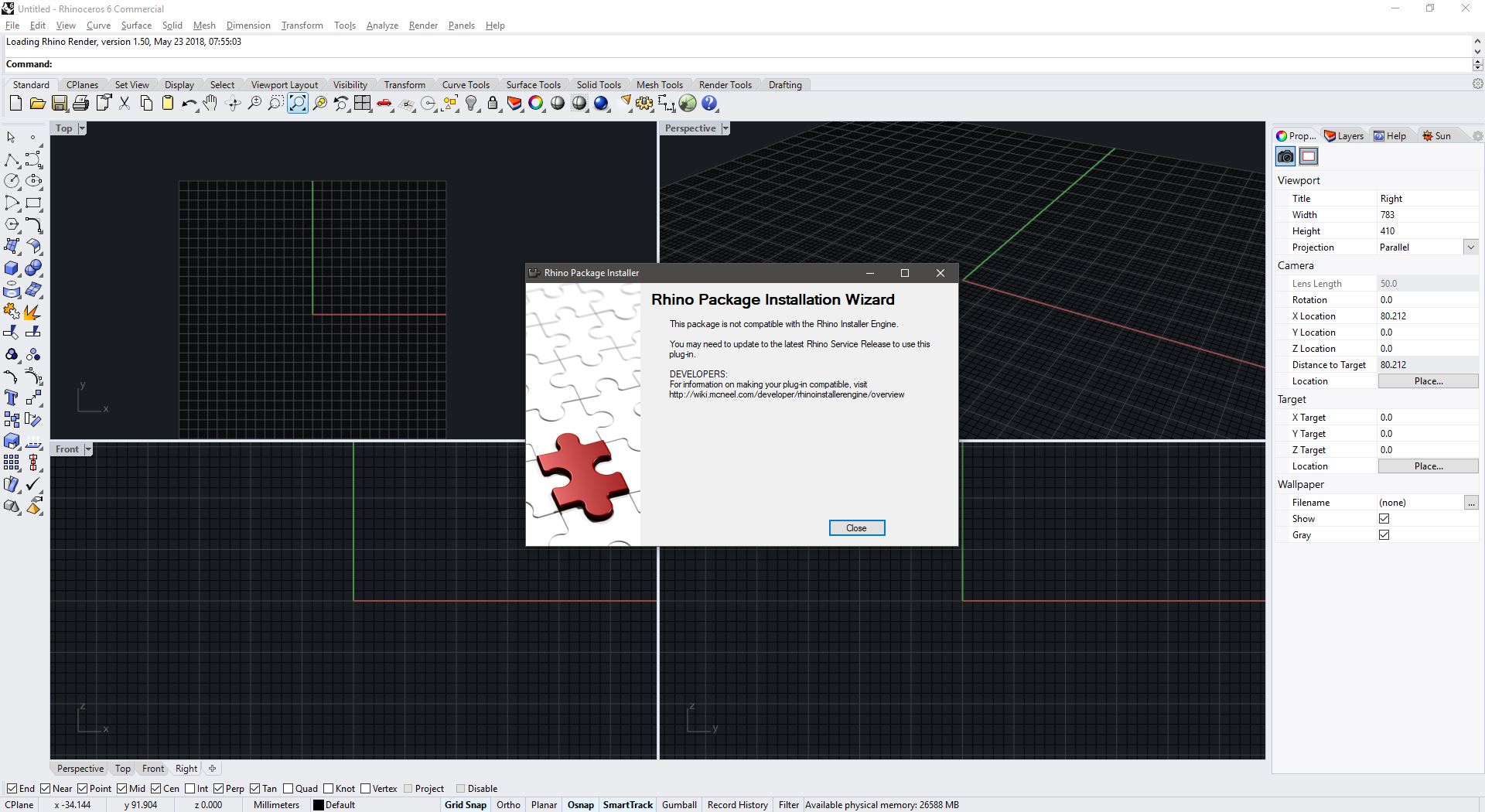

Paul, sorry but no luck!
See attached screenshot.
The version I have is :
Version 6 SR5
(6.5.18149.14421, 5/29/2018)
Commercial
Here is the release notice dated May 30, 2018 : https://discourse.mcneel.com/t/rhino-6- ... able/64056
Win 10 64Bit | Geforce GTX 980 TI HYBRID x 2 | i7 6700K | 32GB
face_off
Posts: 15811
Location: Adelaide, Australia
Version 6 SR5
Commercial
I just posted a new build of 3.08.1.92 in the release thread, which was compiled with RHino6 SR5. Can you pls try it?
