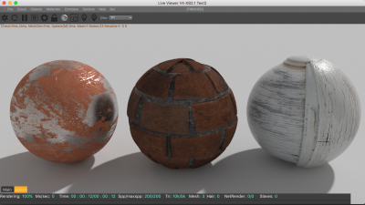

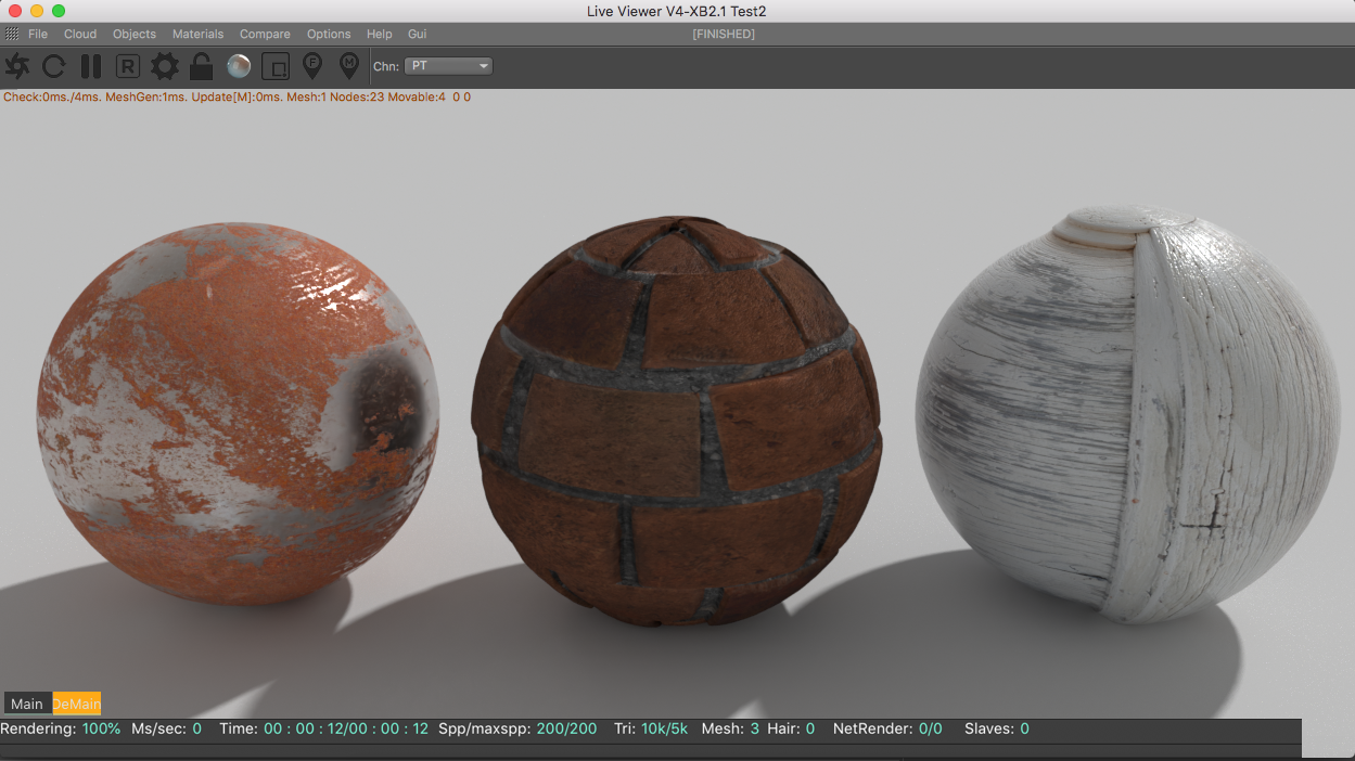

Universal Material in action with PBR materials downloaded from FreePBR:

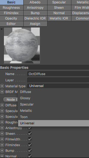

Just create a Diffuse material, or whatever, then change the type to Universal in the Basic Attribute tab:

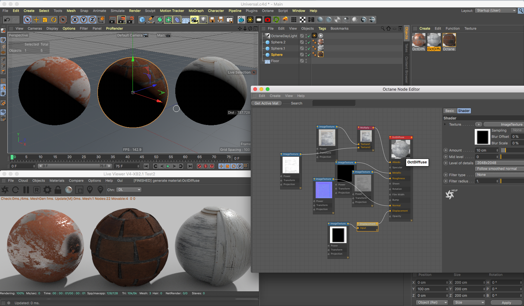

then drag and drop the PBR maps into the node editor and connect to the proper pin. In this example, I had only to change to Follow Smoothed normal option in Displacement, and reduced the Gamma at 1 of the roughness of the metal on the left... no Mix Material or Bland Material used in this example :)

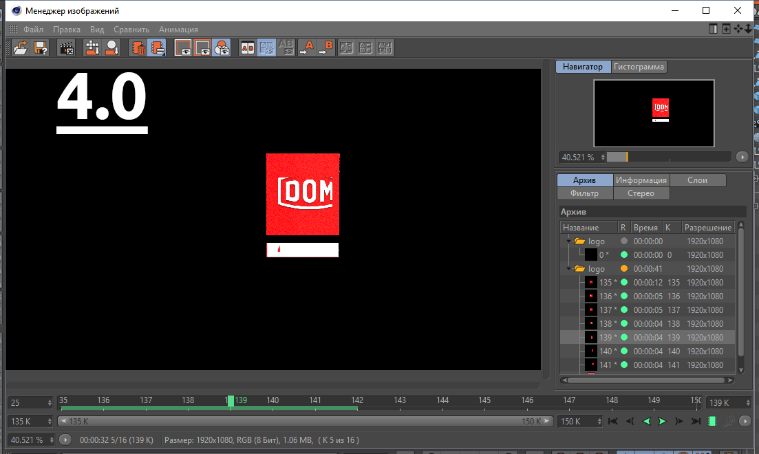

Incorrectly renders.

fleshs wrote:Incorrectly renders.
How is that your renders are doubling time with the 4.0 vs 3.8?
Scene please
The attachment octane 4.png is no longer available
The attachment octane 3.08.png is no longer available
Scene please
logo_test.rar
(132.18 KiB) Downloaded 390 times
