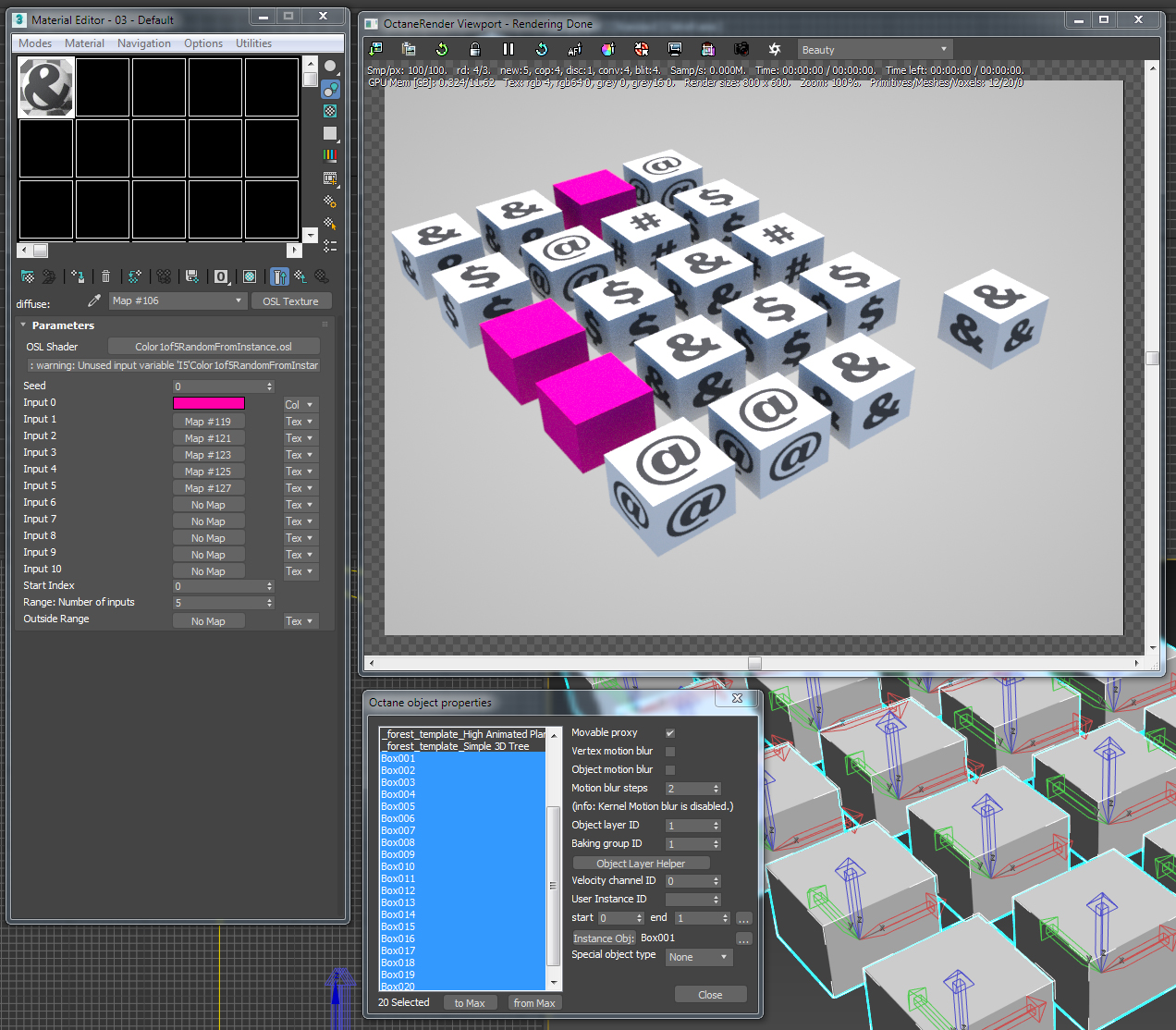

Hi guys,
it does not work with itoo or floor generator, but we will try to succeed.
Regards
Paride

Sorry to be such a pain but is still give me the same missing message although the render does work BUT is not clear to me HOW as I did tried to replicate the scene instancing a cube X 4 and apply the OSL texture onto them but the script is not acting, were should I look?

a small clip how-to.
Regards
Paride
clip.mp4
(2.26 MiB) Downloaded 5918 times
