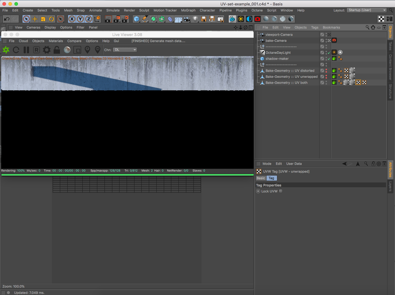

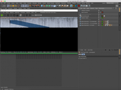

explanation: I've got a plane with regular UV-mapping. After baking this one out, the result is a stretched texture.
So I tried to "unwrap" this plane and get a non distorted UV-Layout, which messes up the texture itself... as it doesn't fit anymore.
Now I wanted to make use of the UV-set-feature inside the Camera-tag where I tried to bake the texture from first UV-layout onto the second UV-layout...
but the result is the same... is this a bug or do I miss the point of this feature and have a wrong understanding of it.
How do I even know the numeration of the UV-sets... where can I see (if there are 2 or 3), which one's the first, second or third... or is C4d just looking how they are arranged.
I'm using C4D R19 and Octane 3.08.

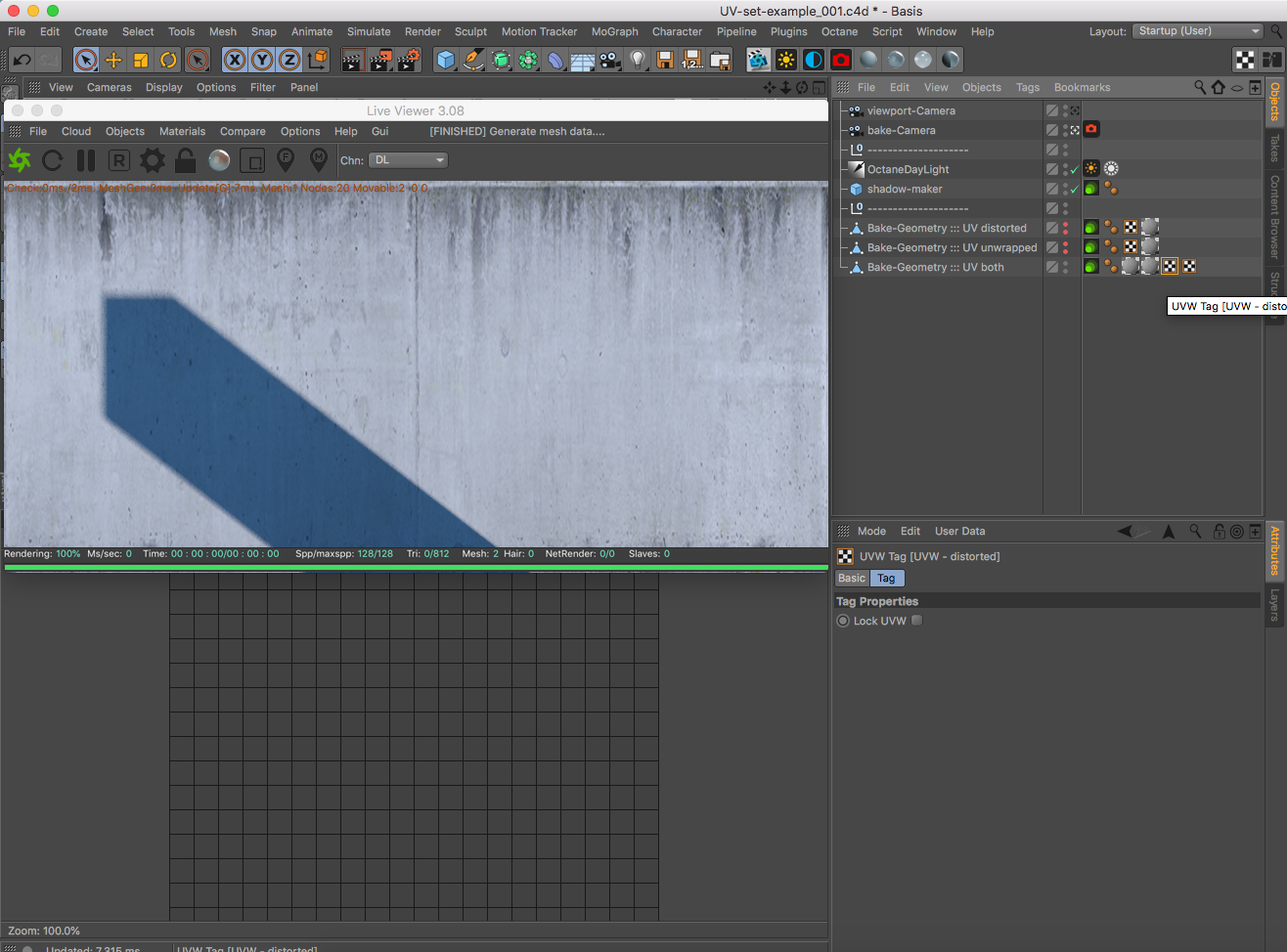

Thanks for clearing this out for me.
Now my real problem is...
while the shadow gets compressed to the new UV-Set, why doesn't this happen to the actual texture itself, which is what I tried to achieve.
At the moment the texture just gets cut away.

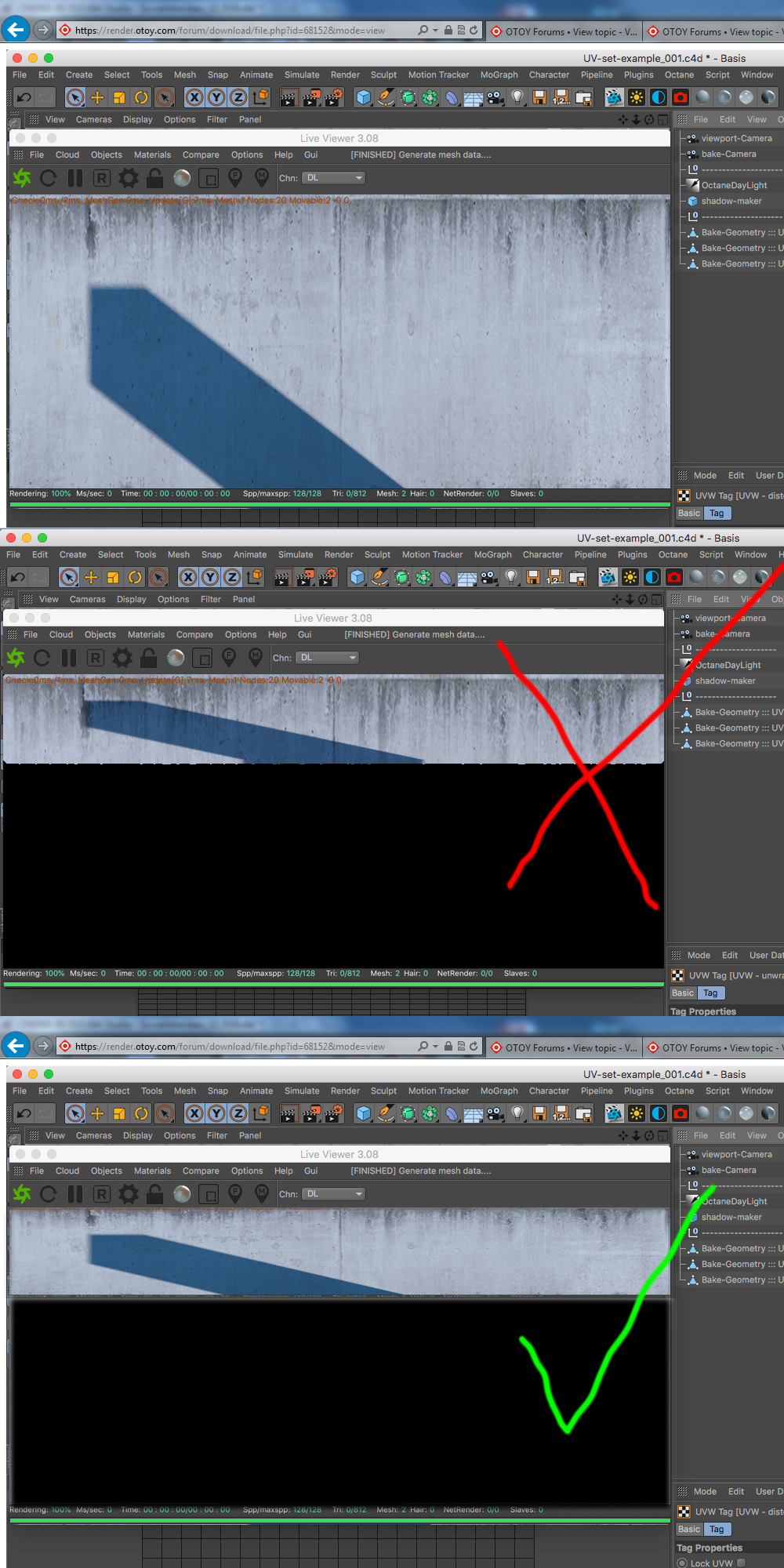

that's what you are actually doing, the texture is cutted, instead of been used completely, it's the same also in Viewport.
What is exactly your goal?

Ok, but do you want to obtain something similar to this at the end?
