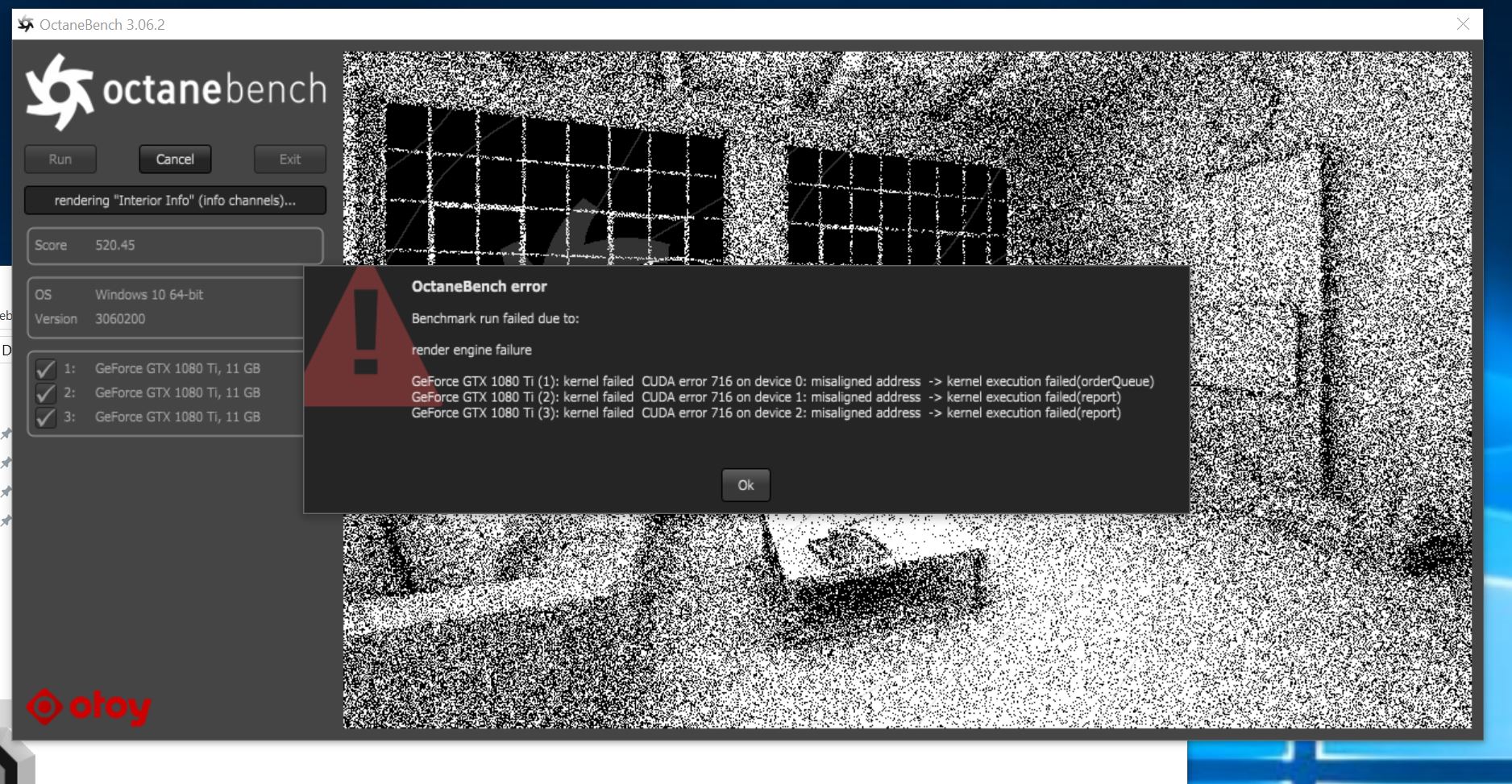

now I tried with 387.92 (I've read in another post)
But when launching Octane Bench I now get Cuda 716 Error
Before --- see my other post please!
Maybe my ASRock X99 Formula OC 3.1 board is totally broken ....
thanks Mike

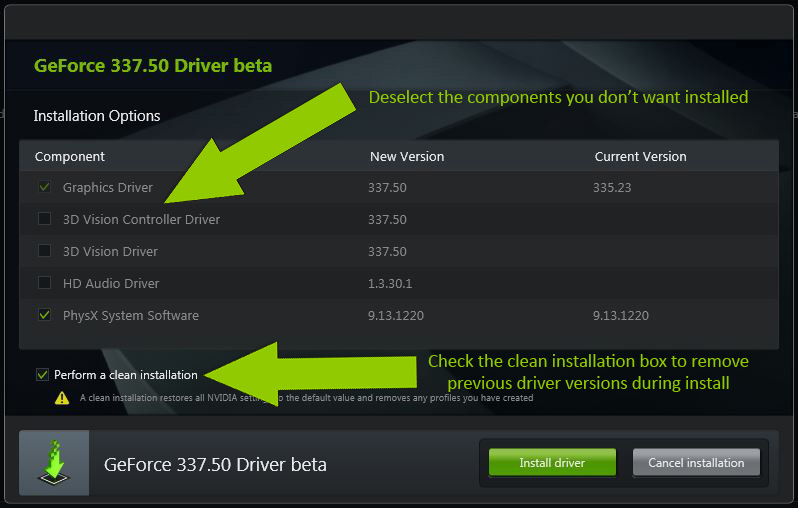

please try to perform a clean installation of 388.13 Nvidia drivers:
ciao Beppe

388.13 is running on all my other mashines fine.
When I've reinstalled a fresh Win 10 (formatted hd) on my problematic Slave (X99 OC Formula) Windows automaticly has installed 388.13
Always for me first thing after a fresh installation, if device manager shows all GPUs and Drivers properly, is to run OctaneBench.
First Cuda 700 Error appears.
Then I made a clean install ( with DDU) with 387.92 (you recommended in another post)
Without any NVidia vision etc. stuff - only driver
Now lots of different Cuda Errors!!!
I have to RMA this Board because of a broken PCIe-Slot "2"
(This Slot is empty right now)
Do you think, that the Board itself could cause all these problems?
thanks
Mike
