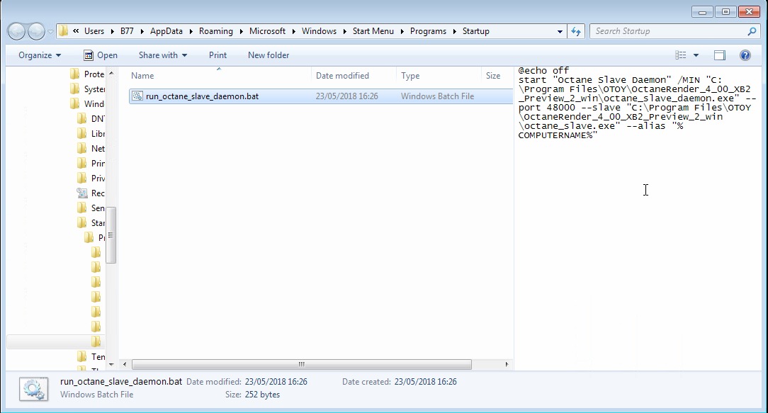

the script install only a .bat file in the Startup directory, please, check the path inside the .bat file: ciao Beppe

Alright, good shout.
So, can I place the .bat file there manually? I dont have a "run_octane_slave_daemon.bat"-file.
This is what my "_run_installed_daemon.bat" says:
https://i.imgur.com/IbznfEb.png
