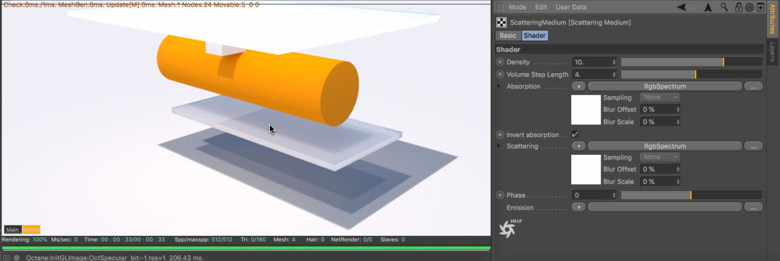

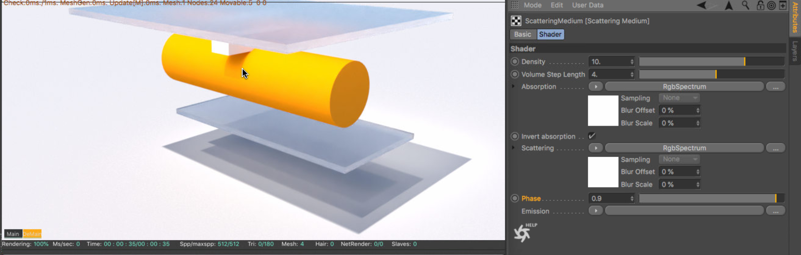

Hi Phil,
have a look at this example with a Specular material with 0 roughness, and medium node:
If you change the Phase value, the light is scattered in the correct direction:
ciao Beppe

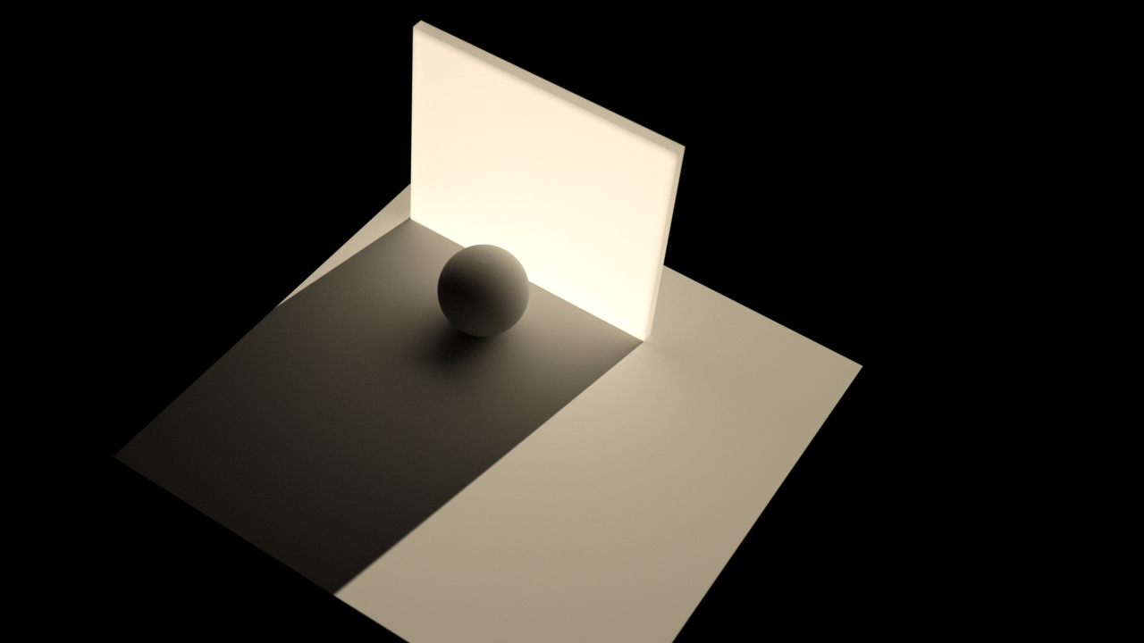

Your examples are completely different. The room is lit by a big area light therefore the shadows are soft. In your Cube example the lighting comes from a tiny lightsource therefore the shadows are sharp. Your SSS Cube can only soften the shadows of objects which are behind it.
I made a little scene for example: The shadows behind the SSS Wall are soft, but the shadows of the wall itself are sharp:
