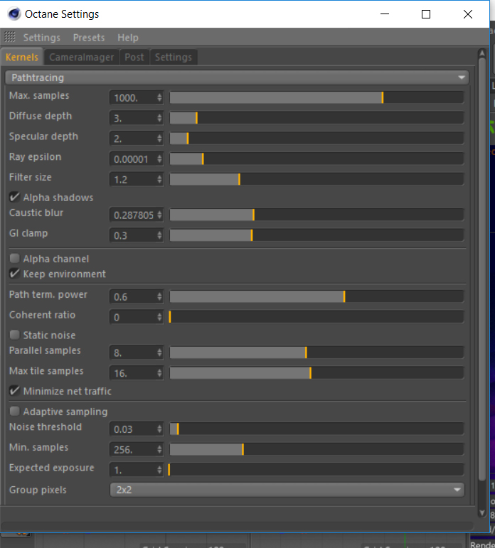

if the loghts are not causing the issue, please post a screenshot of your Kernel settings.
ciao Beppe
karinkim77
Posts: 6
Joined: Wed Nov 29, 2017 4:39 pm
bepeg4d wrote:Hi,
ciao Beppe
hey! linked a picture below:
Posts: 10626
oops sorry for the typo :)
try with this settings:
  • Max Sampling = 4000 (since we will enable the Adaptive sampling, the Max Sampling can be greater)
    Caustic Blur = 0 (with GI Clamp <10, is useles to blur the caustics since they are already lost)
    Path Termination Power = 1 (max speed)
    Coherent Ratio = 0.5
    Static noise = active (when Coherent Ratio is > 0)
    Parallel Sampling =16
    Max Tile samples = 32
    Adaptive Sampling = active
    Noise threshold = 0.05/0.06
    Min Sampling = 512
    Expected Exposure = the exact same value you have in the Exposure value in the CameraImager node
    Group pixels = none
ciao Beppe
