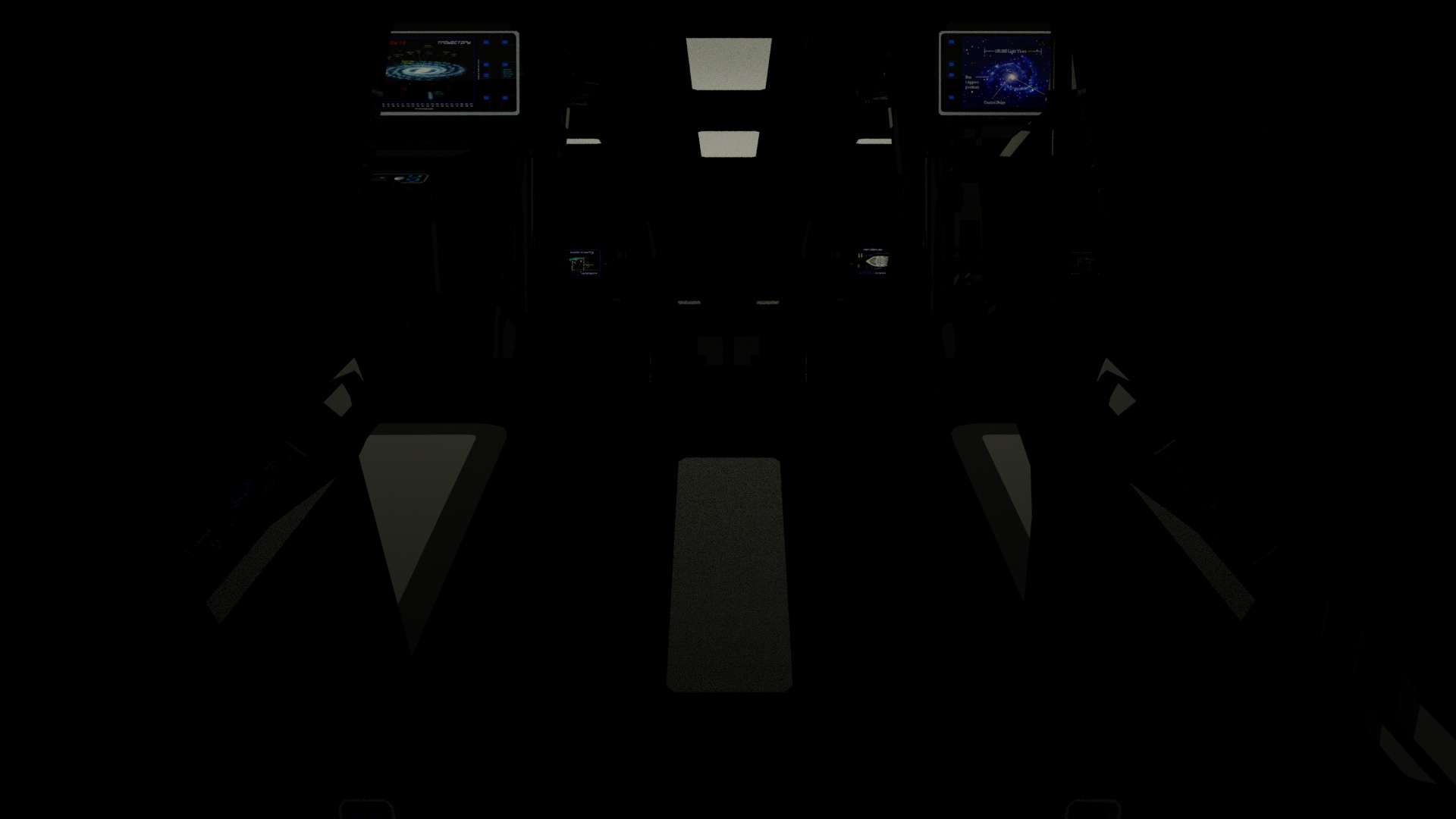

Octane 4 rendering problem
spyrosverykios
Posts: 1
Joined: Wed Mar 18, 2015 10:30 am
When I render with Octane 4 the results get dark. I didn't have this issue with version 3,07. Any suggestion would be appreciated. ( new octane user)
Posts: 10626
there is an issue with HDRI Environment and AI Denoiser in the first test release, related with general SDK, that turns it into black environment.
A new already fixed SDK version should be published soon.
Please, take a look at v4 release discussion:
viewtopic.php?f=85&t=67530
