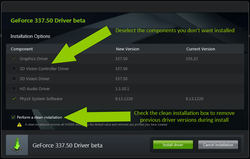

since you are working with 3.06, tray to perform a clean installation af 387.92 drivers:
http://www.nvidia.com/download/driverRe ... /125586/en ciao Beppe
