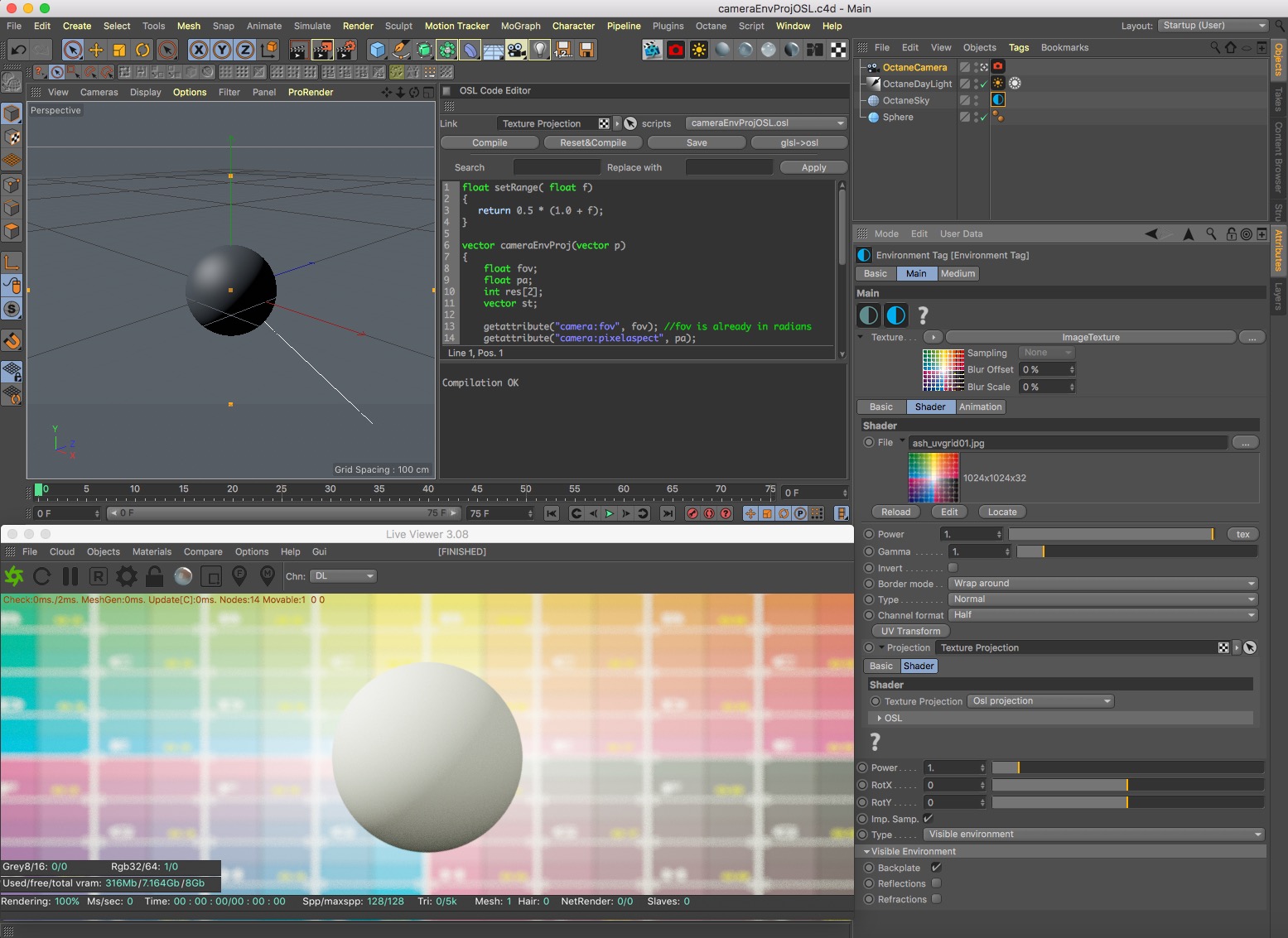

till 3.07-R2, you need to use this XPresso and a Visible Environment node:
viewtopic.php?f=87&t=63808
from 3.08, you can use the Calus's OSL script insted in the Projection node of the ImageTexture used in the Visible Environment node:
cameraEnvProjOSL.zip
(500.95 KiB) Downloaded 248 times
ciao Beppe

bepeg4d wrote:Hi bertritude.
ciao Beppe

The only thing i'd like to add is that to be accurate with the dof values and results, it would be fantastic if some lines of code into the OSL, or some box to enter some value somewhere, could let us adjust the virtual distance of the backplate from the camera ( without changing its aspect ratio ) .... Because the subject pictured inside of the backplate isn't necessarily the same as the infinite distance used for this "environment texture" object.
>> this is important, to have an accurate dof result, a more or less correct distance from the subject to the camera used, and in relation to the objects in the scene. Then, the bokeh result would be adjustable with a lot more accuracy.
How could we do that please ? Thank you !

But, from what you have written, since both solutions are using the Environment node, you should need something different, like a plane parented and facing to the camera, that scales on X and Y, while moved on Z, to be used as backplate at the desired distance :roll:
ciao,
Beppe
