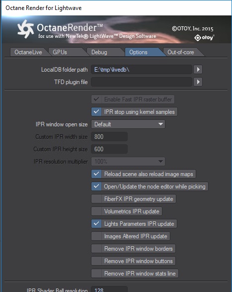

Ah, sorry. Sometimes I forget my own plugin features ;)
The IPR light parameters live update is an optional feature that you need to enable in the plugin options panel, "Light Parameters IPR Update".
Thanks,
-Juanjo
lightvu
Posts: 94
Joined: Mon Nov 20, 2017 6:49 pm
juanjgon wrote:Ah, sorry. Sometimes I forget my own plugin features ;)
