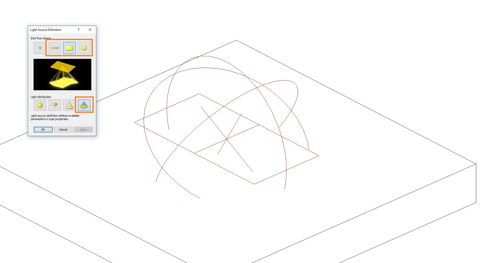

Revit uses a 'Light Source definition'
This source can be:
Point (just create a small sphere to imitate this, but I agree that no source is infinitely small)
Line (Just create a thin rectangle)
Rectangular (nothing to change here)
Sphere (nothing to change here)
The contribution can be:
Spherical (meh, unreal)
Hemispherical (meh, unreal)
Spot (Meh, unreal)
Photometric Web - This is using an IES file, this is the only 'real' distribution. Anything else is seen as invalid in photogrammetry software like Elumtools.
Any emitting material in unrealistic for photogrammetry since it cannot be associated with an IES files (except in Octane).
So using the proper geometric pieces, you can create your own geometry. If I create a Octane sphere to emit light, it will block my sphere that already emits lights for every other rendering software out there! so all of a sudden, iray, Corona, Vray, Arnold, Revit, Elumtools and Enscape will stop working!

Forgot to attach this image

I've placed an image showing you how to expose the light source IES web.
