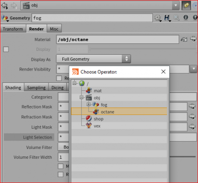

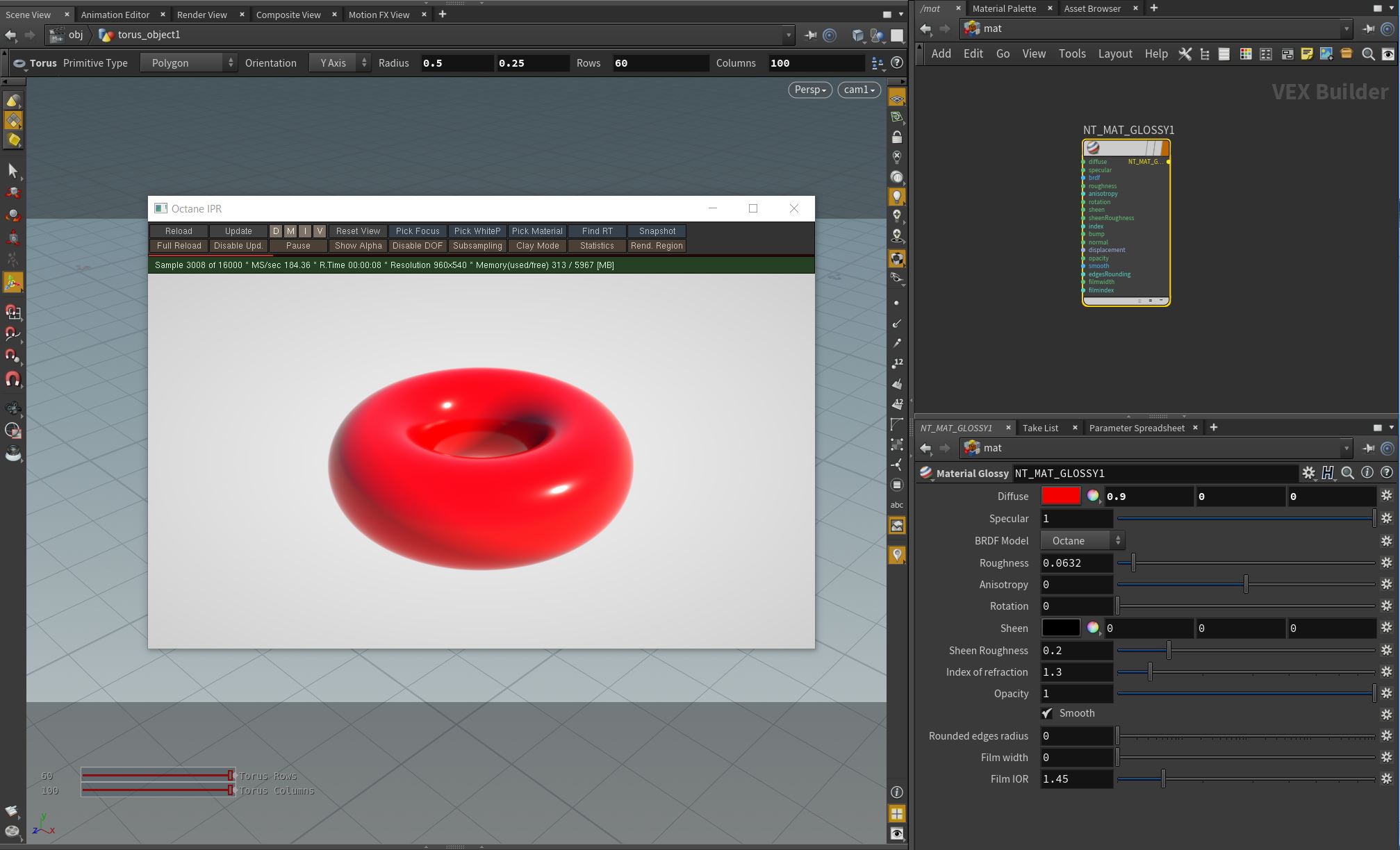

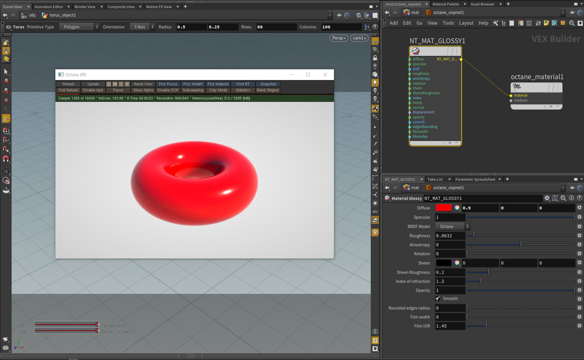

Sorry, I'm not sure to understand your workflow using subnets. In Houdini 16.x you can use the Octane material nodes directly as materials for the objects (while working inside the new /mat networks), or you can add the materials inside a material builder, liking it directly to the material output. Why are you using subnetworks?

Thanks for your very fast answer Juanjo !
Well it's because i am a total has been and was still using the old Shop context to work with octane.
As LiveDB still import shaders in Shop i have the wrong feeling that it was still the default context for octane.
But indeed i have just double check , in the new mat context things work perfectly -> subnetwork if you need but not an obligation !
