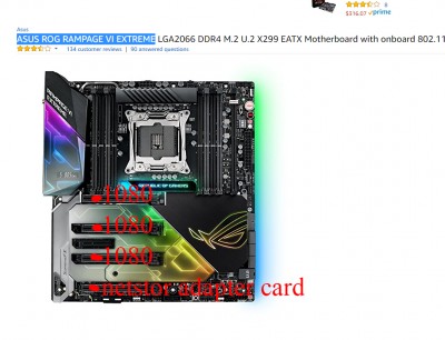

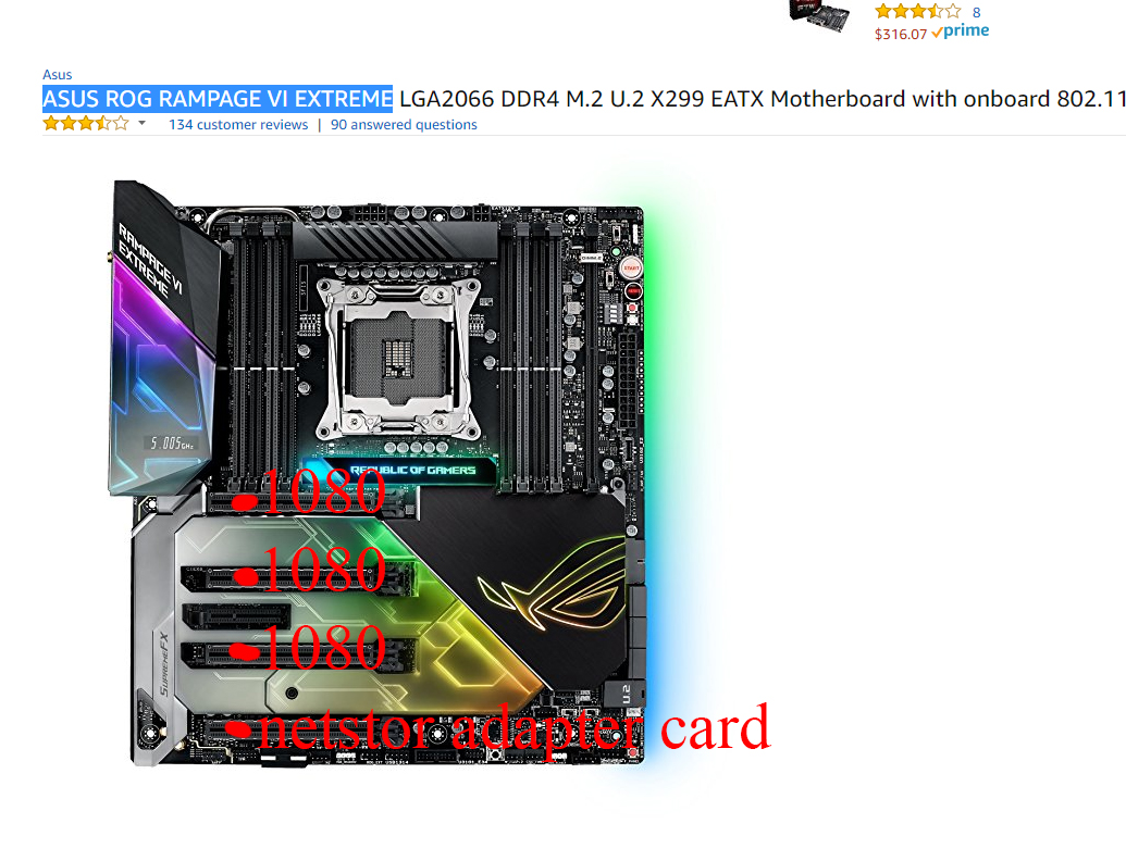

Hi I got this ASUS ROG RAMPAGE VI EXTREME motherboard and 3 top PCIe slots are used for 3 X 1080s the bottom 4th one is for netstor turbobox na255aadapter card.
When I connect netstor turbobox na255a to this PC with just 2 cards in nestor computer boots up fine. But adding the 3rd and the 4th video cards to netstor computer won't even boot to the bios. I need total of 7 GPUs 3 in the main PC and 4 in the netstor. 4G decoding is enabled. I am not sure what to do. Does anyone know what can be done. I was also installing one card at a time to the netstor box. Thank you!
This is the BIOS for ASUS ROG RAMPAGE VI EXTREME https://youtu.be/tmvpO068XX4?t=19s Do I need to tweek anything else or since the mother board only has 5 PCIe slots that's why I can only have 5 GPUs. My CPU is i9-7900x
