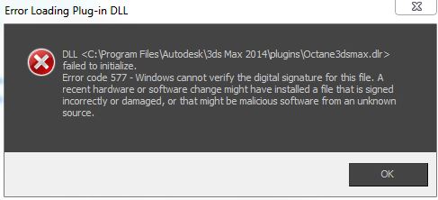

So my question is, is this fixed now because I've tried to install the latest version and I get the following error when booting up 3mdasmax :
Phoenix glitches and new octane install error

The error you see usually happens in old versions of Windows 7 which don't support newer digital signature formats, you can find more information and how to fix it here:
viewtopic.php?f=24&t=67172
