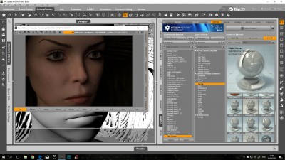

After that try to apply the
clear cornea material
to the cornea
Clear Cornea Material from live DB
You can download it for free from the liveDB material as a good start.

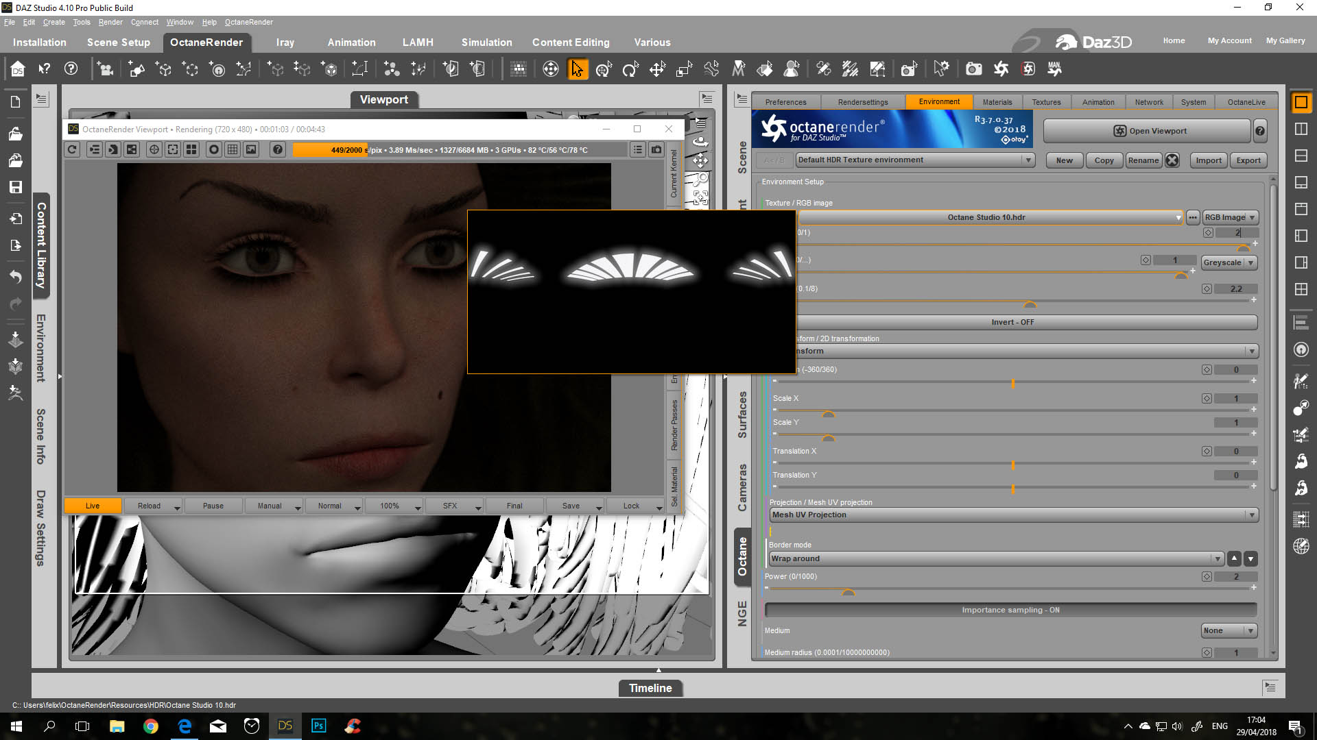

If you do not have a scene with custom light setup yet the Octane Studio HDR 10 may be a starting point to check how subtle reflections in the cornea look like.
Octane Studio 10 HDR

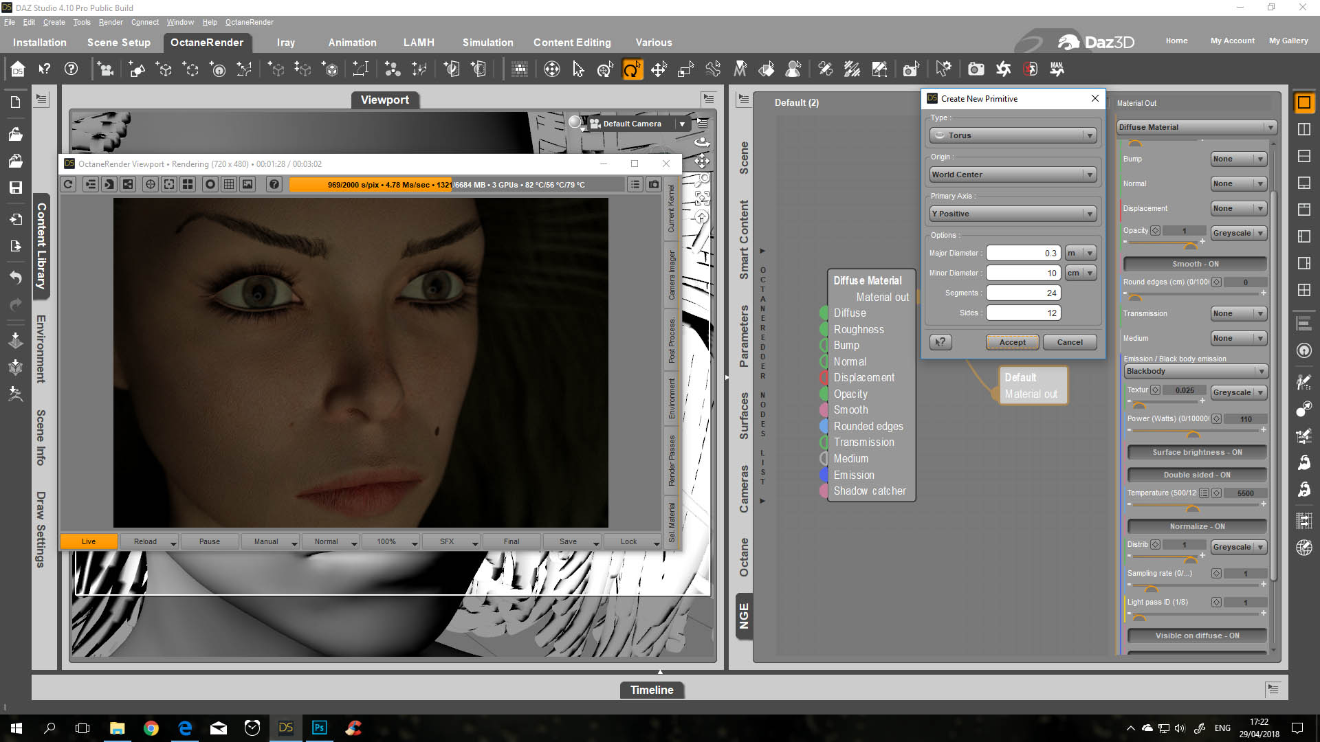

You can also use a Torus primitive to create a simple ring light.
Torus Ring Light
Torus Ring Light
Experiment with diameter, power, distance to subject to get different results...
In the posted example images the reflections in the eye are very difficult to spot because the light setup is very low key.
I just tossed this together quickly so you have a starting point.
Other users hopefully can share different ideas how to improve the look of the eye.
