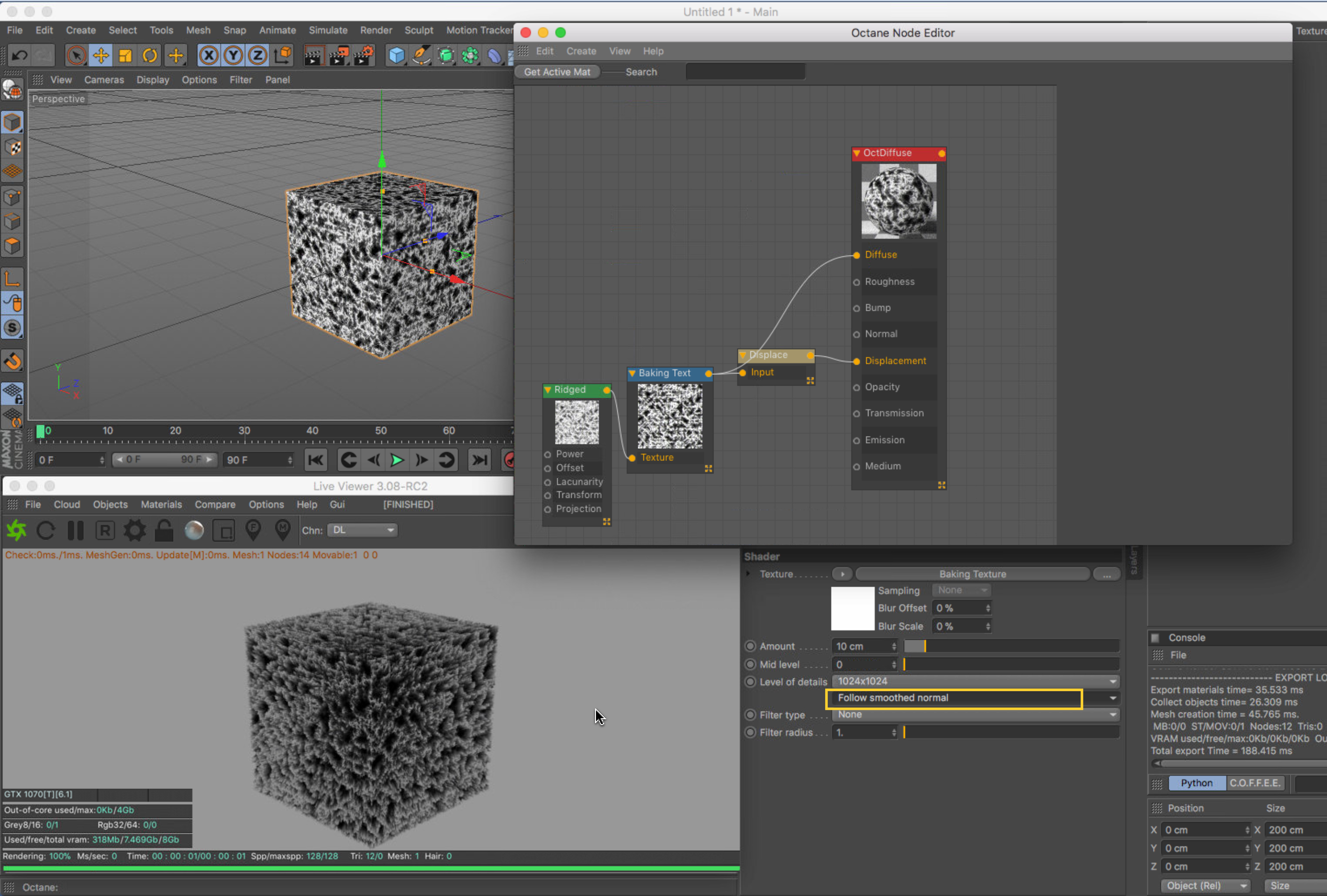

please, have a look at this post about displacement in c4doctane:
viewtopic.php?f=30&t=62095&p=317480&hil ... it#p317480
Note that in 3.08, the displacement has been enhanced with a new smoothing option:
