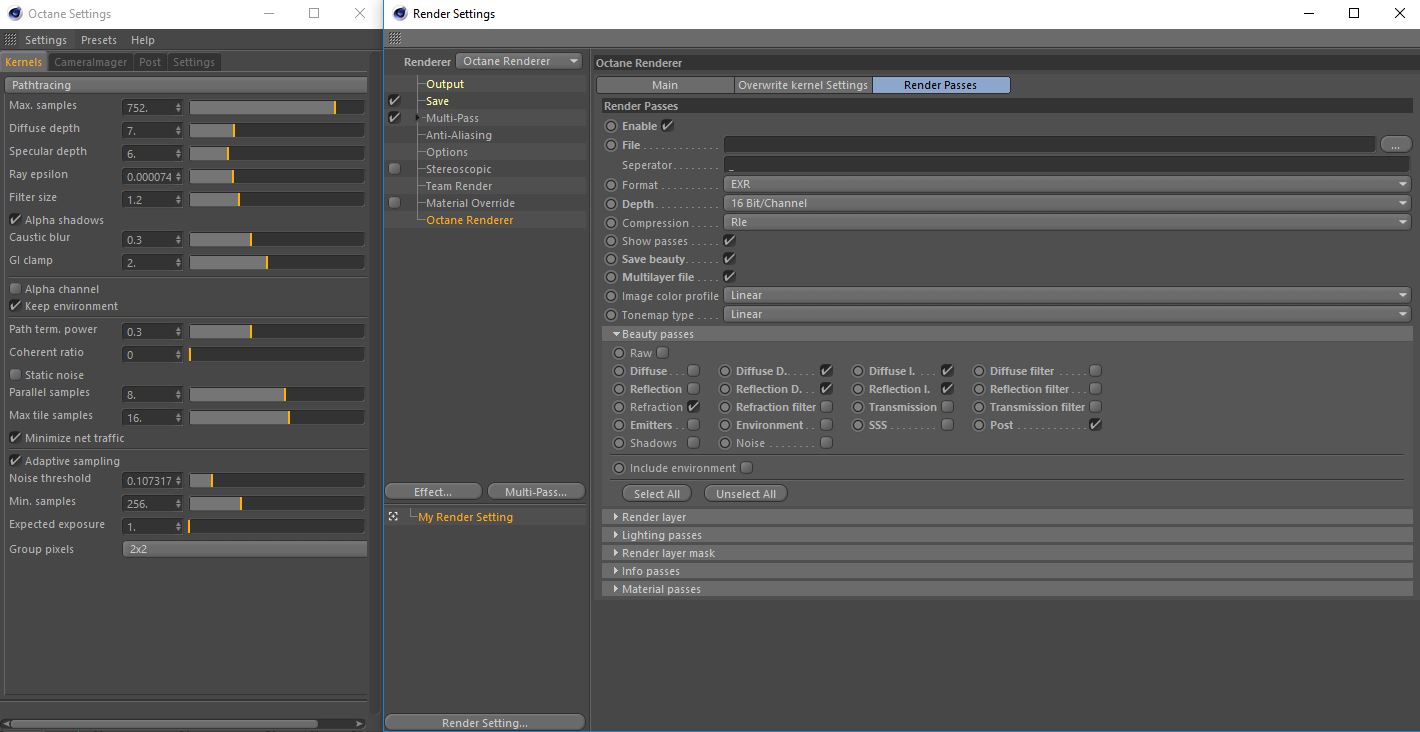

I have been working on an animation for the last week or so and today I started to set it up for rendering passes tests, but as soon as I enable the option in the render settings It manages to render a few frames in a sequence, then it crashes.
It still works fine if I dont enable passes and just use a TIFF sequence for example.
Attached is the crash log - first part is a tiff sequence only, then the second part is with passes enabled.
I can see that its suggesting to lower the subdivision levels, but I only have one thing subdivided and at a level of 1 in the renderer - even if I turn it off it still gives the same error?
I have also attached my kernel settings and the passes I am trying to render out.
Any thoughts or help would be highly appreciated - the work is for a client and so confidential, so I cant really upload the file.
