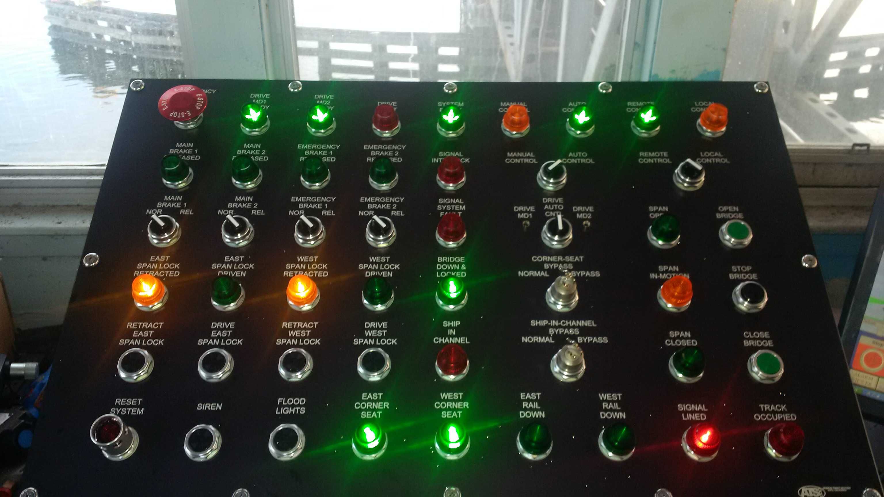

I'm trying to make the effect of a light bulb that is under a translucent cover, as in the attached picture.
Is this best way to do this a specular material with a colored transmission on the cover, and then just a sphere with a bright emission texture within it? Or is there a way to do it in a texture, maybe with a falloff?
Thanks!
Glowing control panel light with bright center

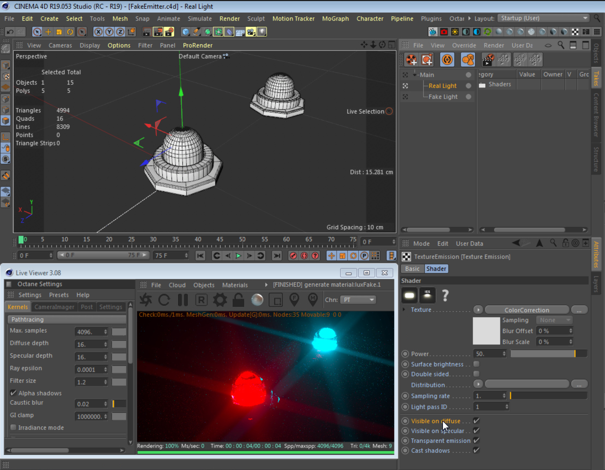

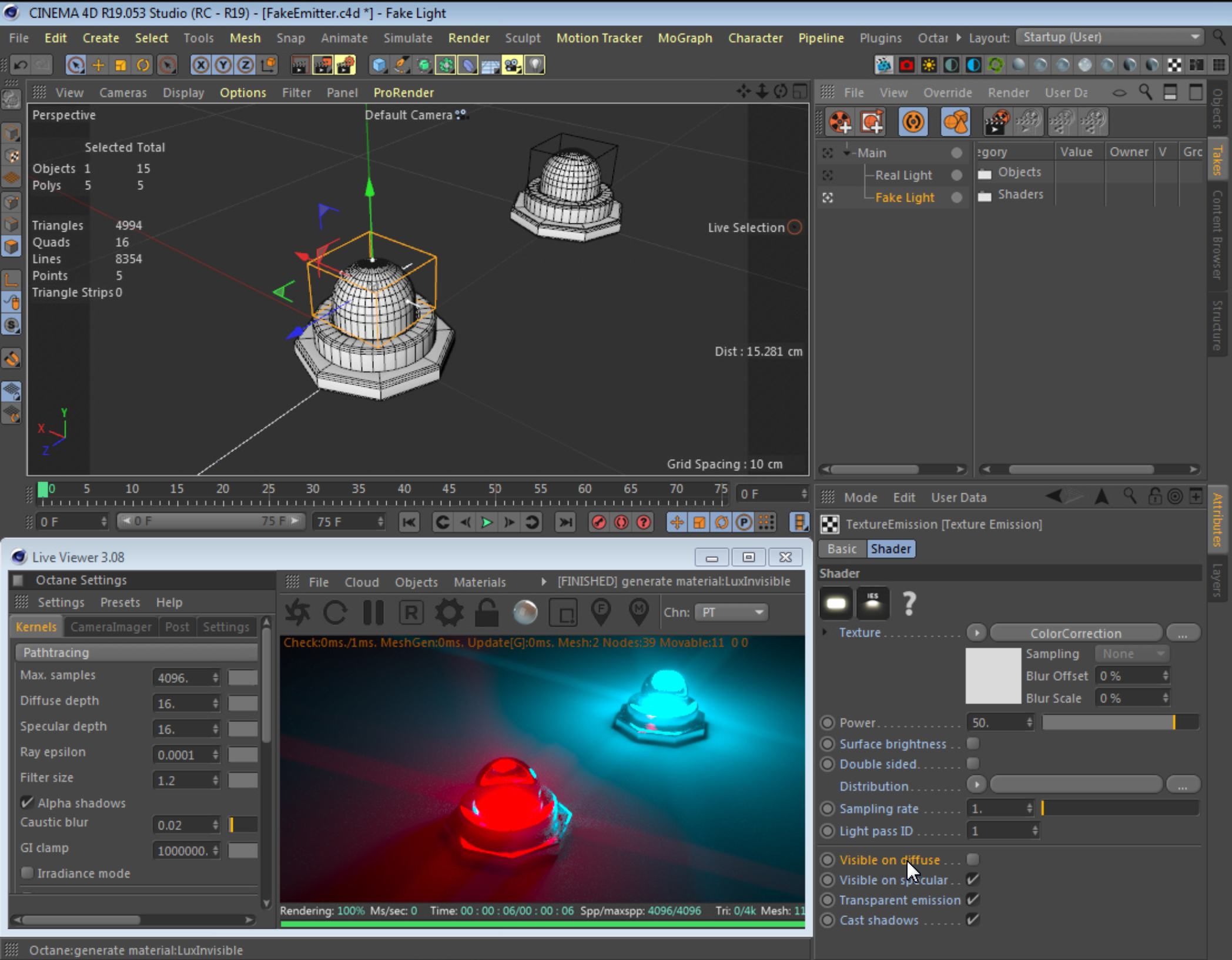

here is an example with 3.08, with and without the invisible emitter in two different takes.
Real Light take with Visible on diffuse active, and the Invisible emitter deactivated: Fake Light take with Visible on diffuse deactivated, and the Invisible emitter active: You have much more control with two different emitters, the visible one for the post effect, and the invisible one for the illumination, and the rendering is super fast and clean.
The invisible emitter should be more simple as possible, without overlapping any other polygon.
Here is the scene file: ciao Beppe
