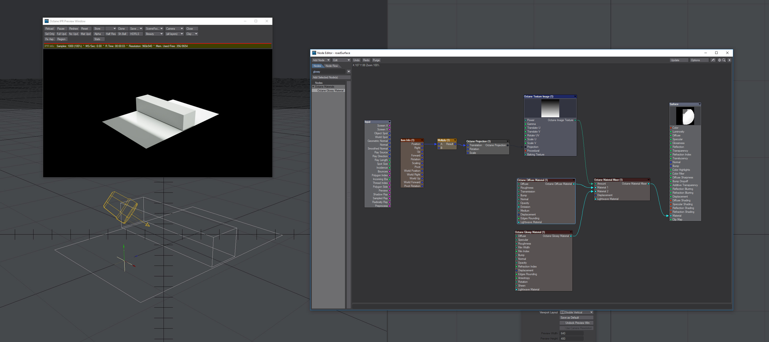

You could try something like this:
I normally create a simple gradient texture image and then link a projection node to the position properties of a null object. The only small hack is that Octane's z dimension appears to be flipped compared to Lightwave's, so use a multiply node to flip the coordinates you're using.
Moving the null doesn't generally cause the IPR to refresh. Nudging the timeline forward and backward one frame does the trick.
Good luck,
J.
Good luck,
J.
