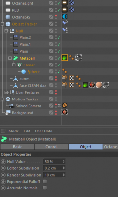

I have a quite simple scene with spheres in a cloner in a metaball.
Metaball in showing in the live viewer, evrything looks perfect there,
but then when I render, everything is totally black.

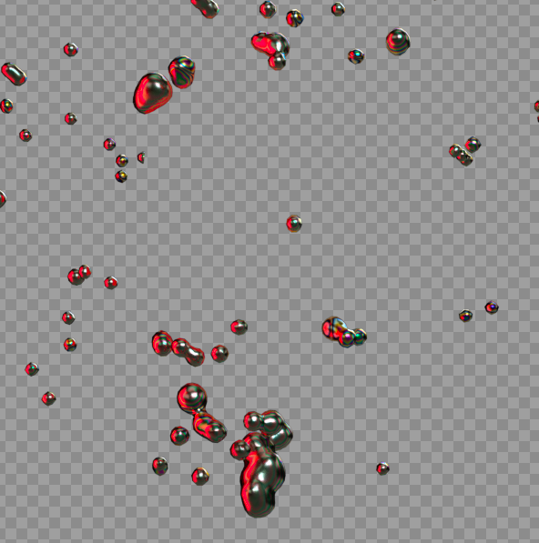

Here is what I see in the live viewer :

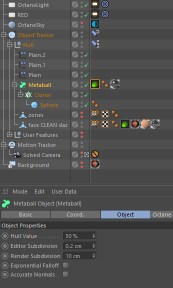

Here are my objects :
What could be the problem ?
Thanks so much for your help !
Posts: 16067
Location: Türkiye
Check with same subdivision value as much as in editor mode.
