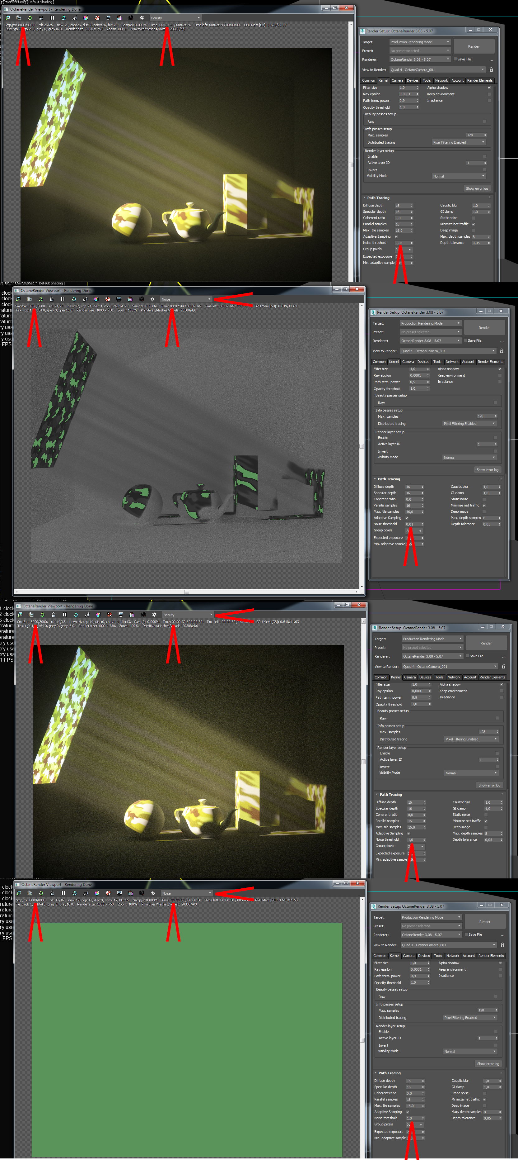

Using adapting sample tool, for example you can set the noise threshold level you want and then how fast you want samples takes to reach goal.
https://docs.otoy.com/StandaloneH_DEV/S ... g%20sample
