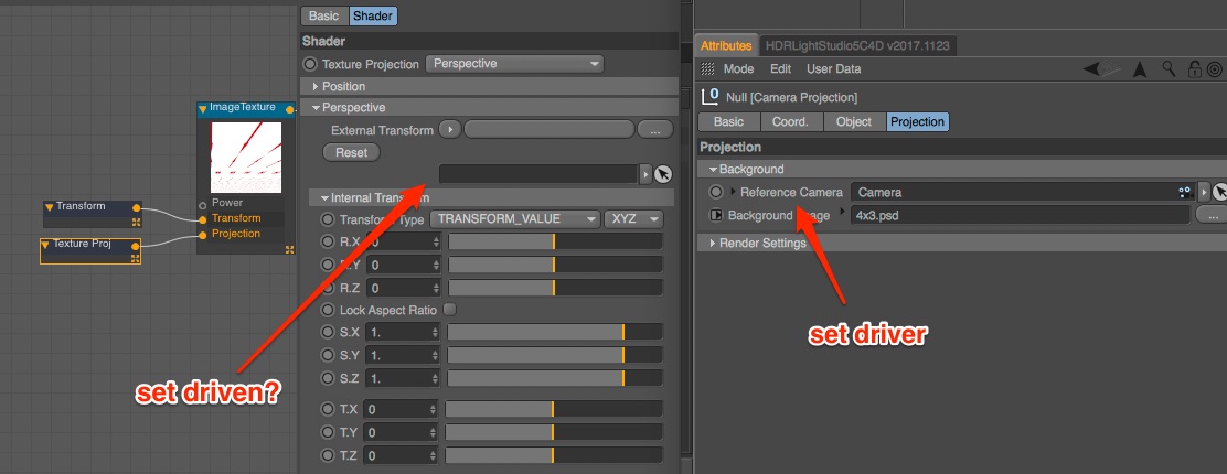

I'm very new to xpresso, but I'm working on a setup to help with camera projection.
I can't seem to link to the camera field inside of Texture Projection > Perspective.
For all the other "Driven" properties I right clicked on the text labels, but this one doesn't have a label.
Is that currently possible?
Cheers

It's possible if you replace "TextureProjection.str" with this modified file. Under to c4doctane\res\strings_us\description\
TextureProjection.rar
(892 Bytes) Downloaded 169 times

Thanks Ahmet,
Works Great!
