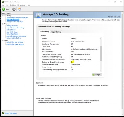

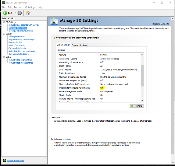

Hi guys,
this could help people using open rings, risers..
realistic-design said:
**MAKE SURE YOU ACTIVATE THE "OPTIMIZE FOR COMPUTE" IN THE DRIVERS SETTINGS IN THE NVIDIA CONTROL PANEL** (recent drivers only and win10 <= not sure)
also, you want to disable *all* the nvidia hdmi sound devices in the device editor as it causes the watchdog to trigger sometime on big renders, hence restarting the drivers & crashing the render.

Can you maybe post screen grab of those features/check marks where are they in Nvidia control panel? I have 390.01 drivers and can't find them but would be nice to check so we know for sure which driver is start of that feature.

Hi Lewis,
I asked for a screenshot to realistic-design; I use 388.x and works fine, I don't like to install 39x.x

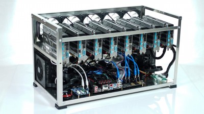

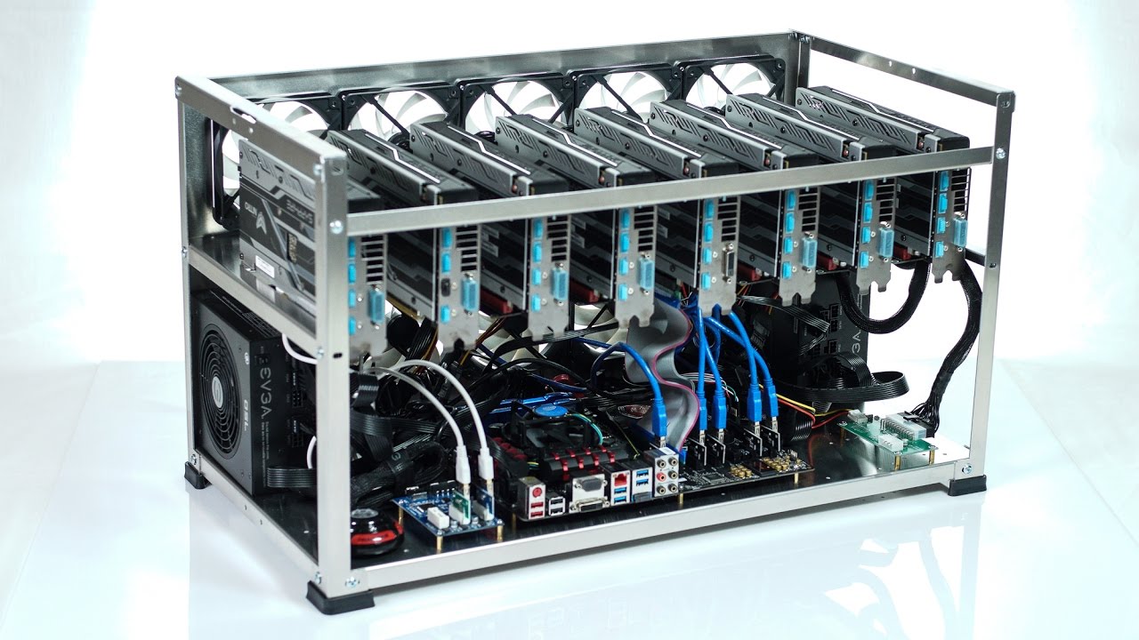

I'm sorry...but what are OPEN RINGS?

...and what are risers?
paride4331
Posts: 3962
that's it

so you mean open RIGS not riNgs ?? :)
