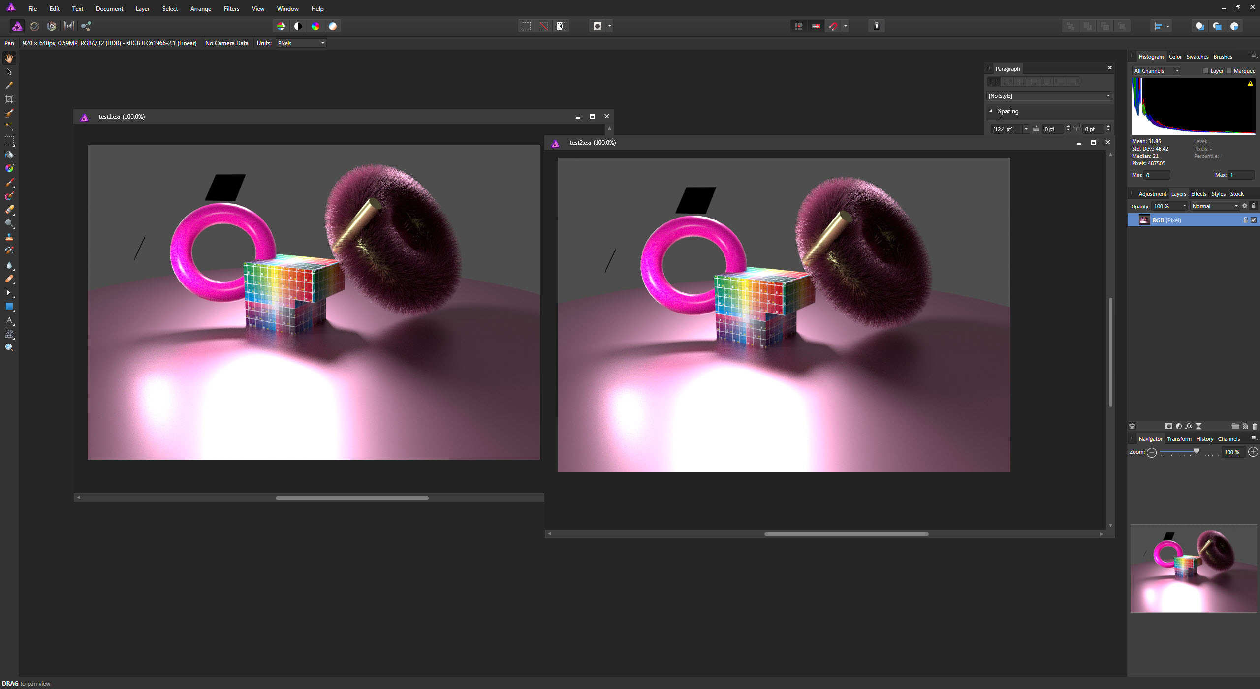

You made me have to test it again. I cannot see any differences between both of methods. See my test. How do you really open and compare? I'm using default settings of Octane render settings.

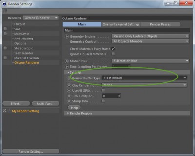

I and you missed this, you can't compare float(tonemapped) vs. exr saved from LV. Float(tonemapped) buffer is clamping values, you should use Float butter.

Posts: 16066
Location: Türkiye
This one

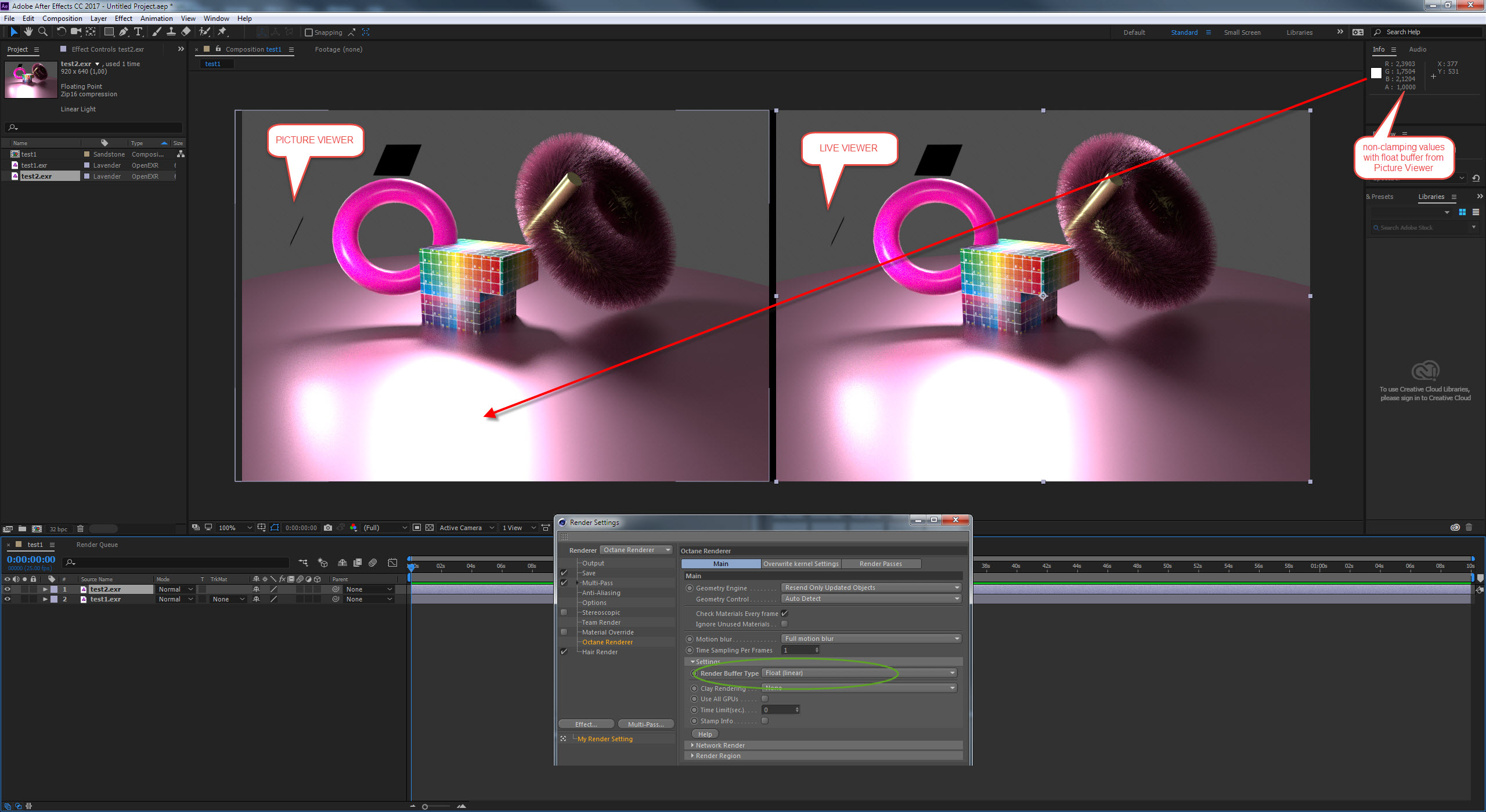

do you have any idea how to save correctly from native Picture Viewer in Cinema file in 32bit exr?
Sorry couldn't get what you mean correctly? It's correct for my opinion, see after effects test. If you use passes with "Linear" buffer, they will not be tonemapped. They will be seen like darker than what you see in LV. LV is always tonemapped for main buffer or passes.
