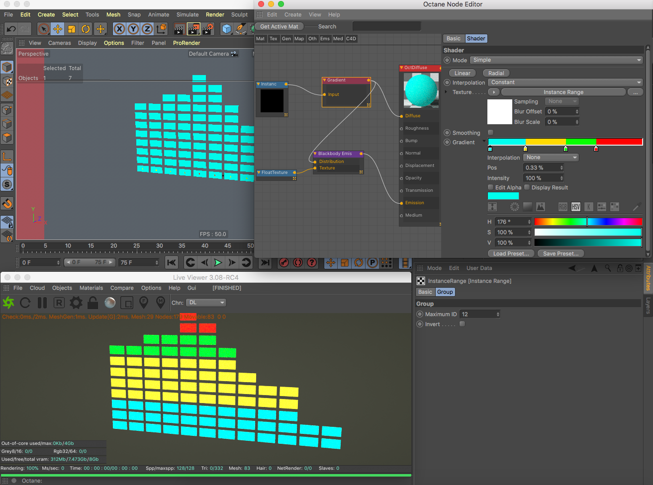

instead of using a c4d shader, you can use the Instance range node with an Octane Gradient to do the effect:
EQ_0001.c4d.zip
(2.08 MiB) Downloaded 187 times
