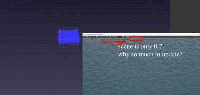

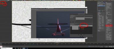

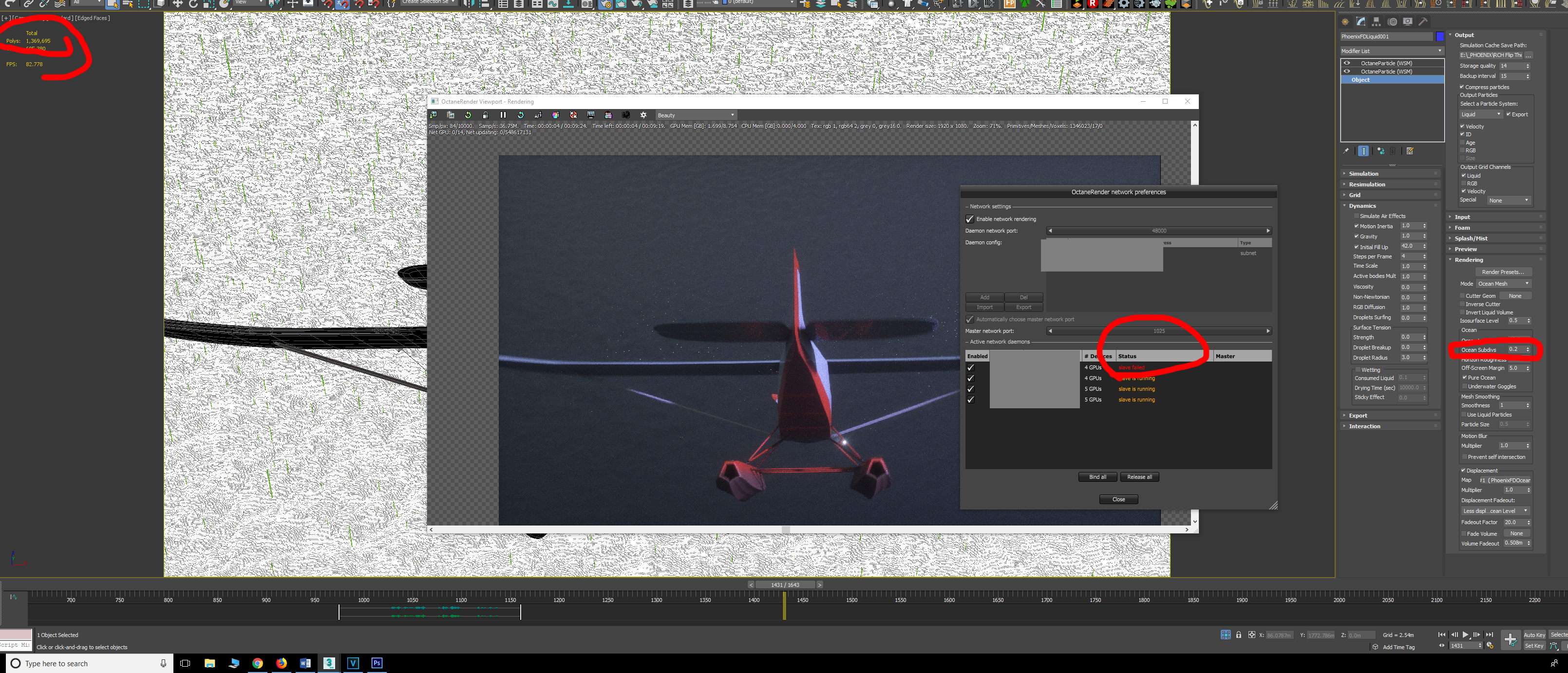

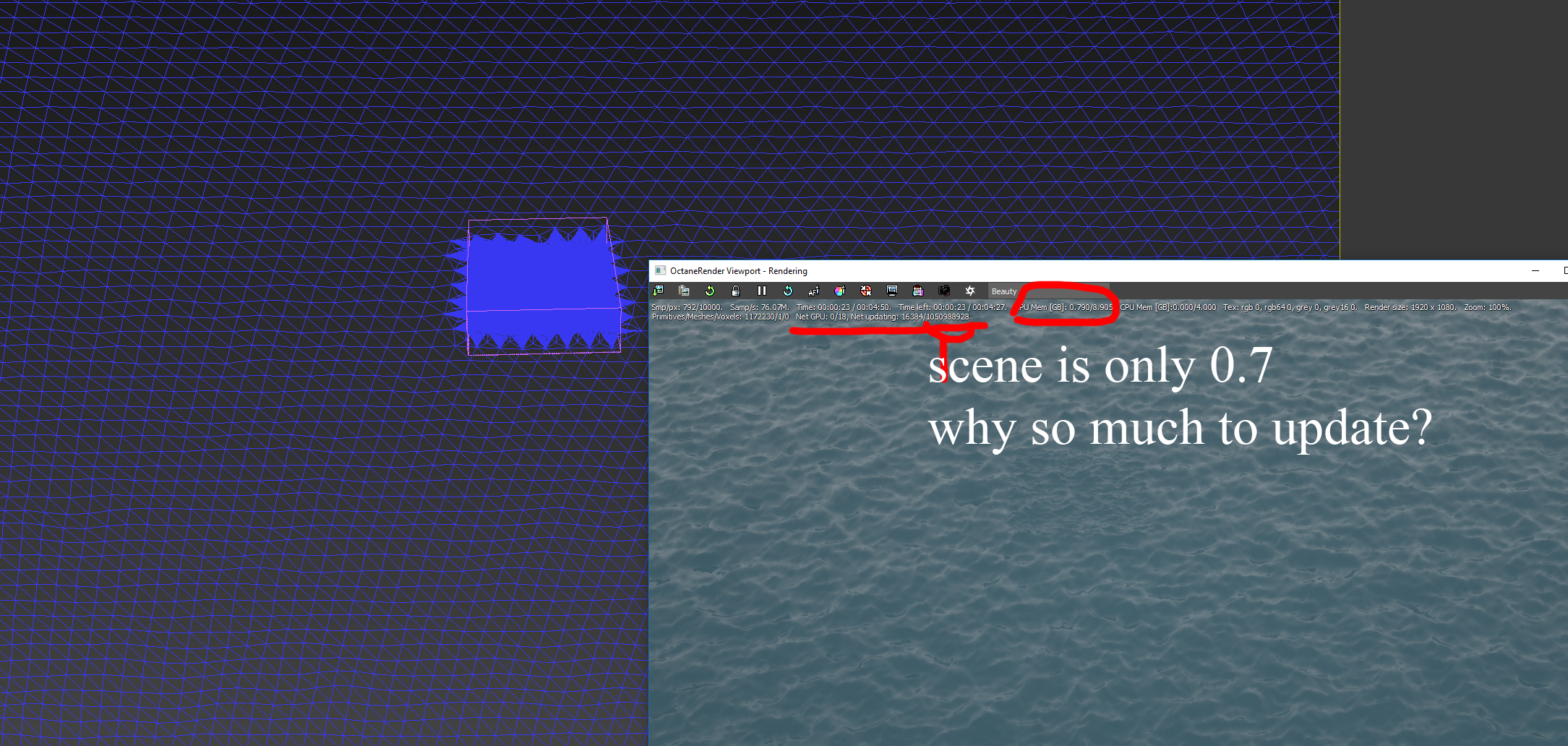

Hi I attached the scene Please render it with network slaves. The scene is only 1-2 Gb and net updating takes forever. The problem is Phoenix FD Ocean. Not sure why but master loads the scene in 5 seconds slaves takes 10-15 min. So by the time master finishes rendering one frame slavesdont even have time to do net updating but the scene is only 2 Gb There is something with wrong with phoenix ocean/liquids and slave load times.
if you can render Camera 06 frames 1375 - 1500 or open octane viewport you will see how slow slaves update
we used phoenix 3.04.02 and octane 3ds max 3.07
Phoenix Ocean and Slave net updating times

I also want to add when you open octane viewport move a time slider 1 frame then go to Phoenix Fd> Rendering tab > change ocean subdivision to 0.2 it will create ocean as mesh with about 7 mil polys you can actually see dense mesh in viewport. But it is only 7 mil poliy why it takes slaves 15 min to update? It is just a dense displaced plane that changes shape every frame. And it crashes slaves all the time
Also if you uncheck Pure Ocean in the rendering tab (to hide the ocean) and reopen octane viewport you will see how much faster slaves update
Ok after lots of test it looks like the 4th slave slows down the network. When this slave is enabled our render time goes to 7 minutes with net updating very slow and it only happens with phoenix ocean. After this MASTER PC must be restarted and that slave must be disabled (having 3 out 4 slaves left) and then render time goes to 3 min. Other scenes work fine with that 4th slave slave. I am not sure how this slave messes up net updating/local network so bad with phoenix ocean that master PC must be restarted. Can you still check on your end? I am out of ideas how to fix it. All these mysterious software bugs noone know how to fix
