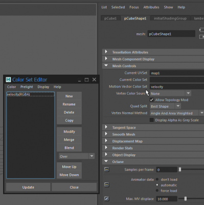

yes you need to disable "constant topology" in 3.07 plugin (version 11.11 and previous ).
in the new beta 3.8 plugin ( from version 12.9 ) the velocity vertex map is automatically used for motion-blur and you can adjust the strongness with "max MV displace".
Also don't forget to tell Maya which color set is used for Motion Vector :
