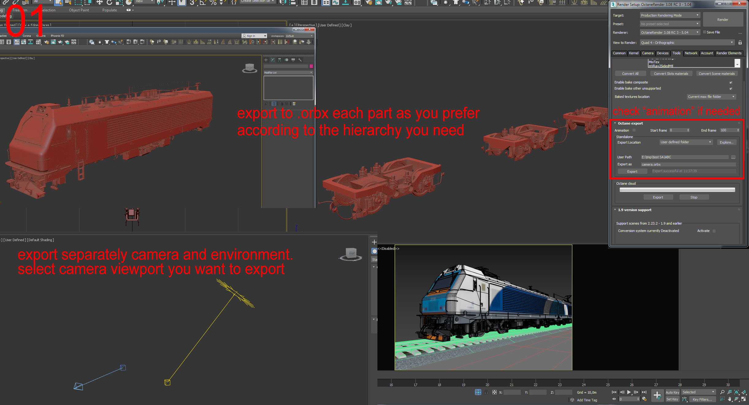

01 export to .orbx your scene by grouping geometries according to your favorite workflow. Export camera and environment separately.

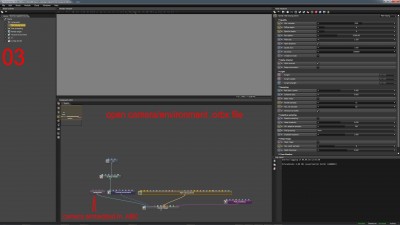

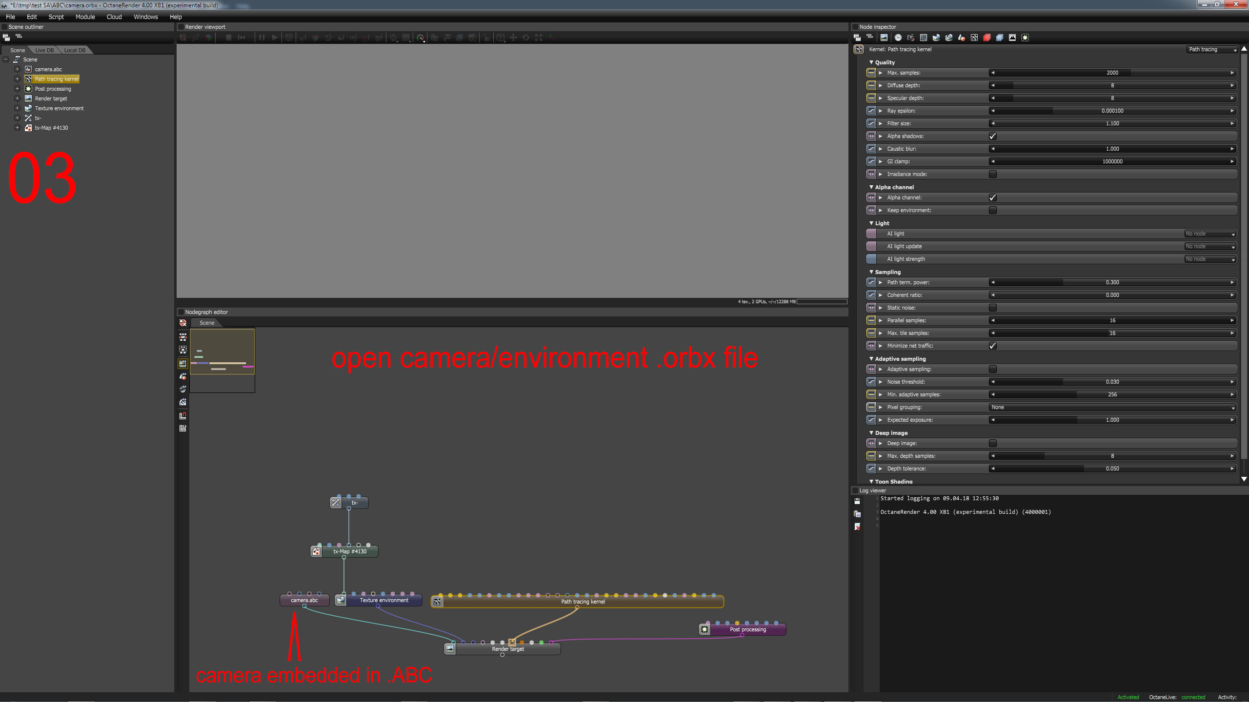

02 open camera and environment .orbx and expand Render Target > click on Render target > rightmouse button > expan [OctaneRender_for_3ds_Max_3.08.1_-_5.10]
03 create scripted graph and load thin lens camera Lua script (attached scene with it) [BEFORE OctaneRender_for_3ds_Max_3.08.1_-_5.10]
04 create Thin lens camera [BEFORE OctaneRender_for_3ds_Max_3.08.1_-_5.10]
05 connect scripted graph to Thin lens camera using pins: Focal length, Focal depth, position, Target, Up-vector (to identify them rollover pins). Disconnect alembic node from render target. Connect Thin lens to render target. [BEFORE OctaneRender_for_3ds_Max_3.08.1_-_5.10]

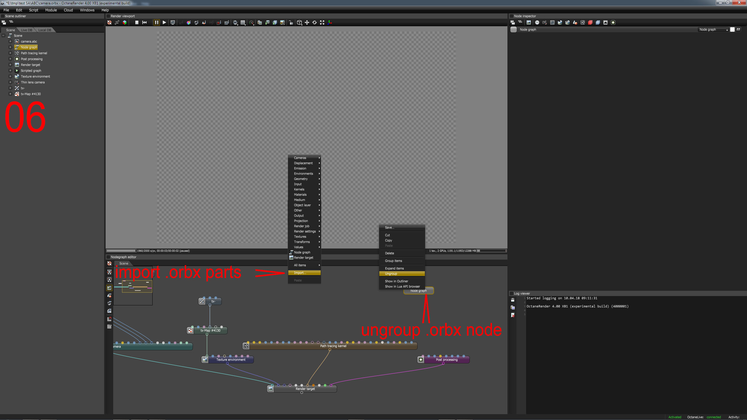

06 import .orbx parts and ungroup it.

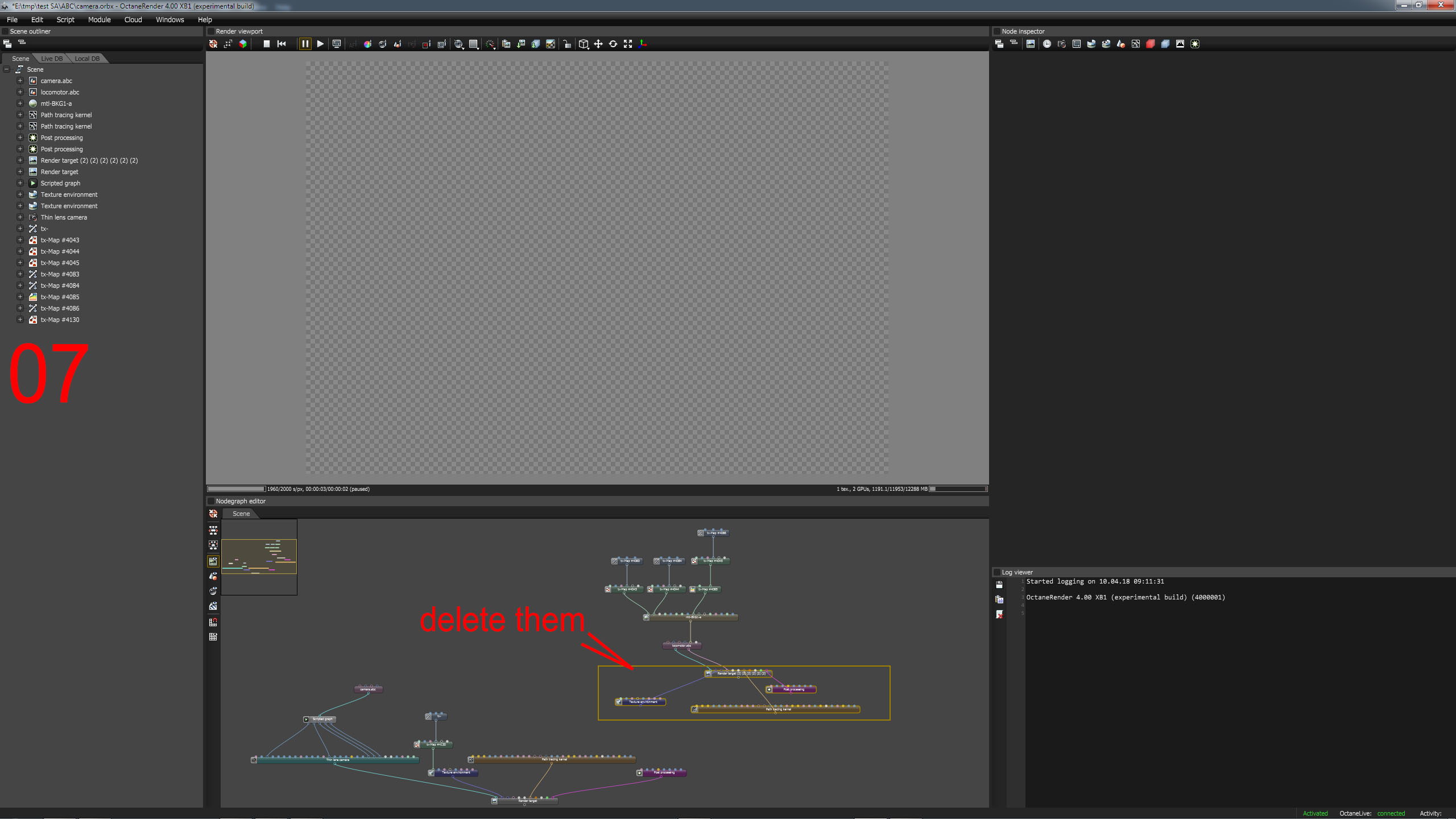

07 delete render target, texture envirnoment, post processing and kernel nodes. You can also double click on it and edit it before doing a group.

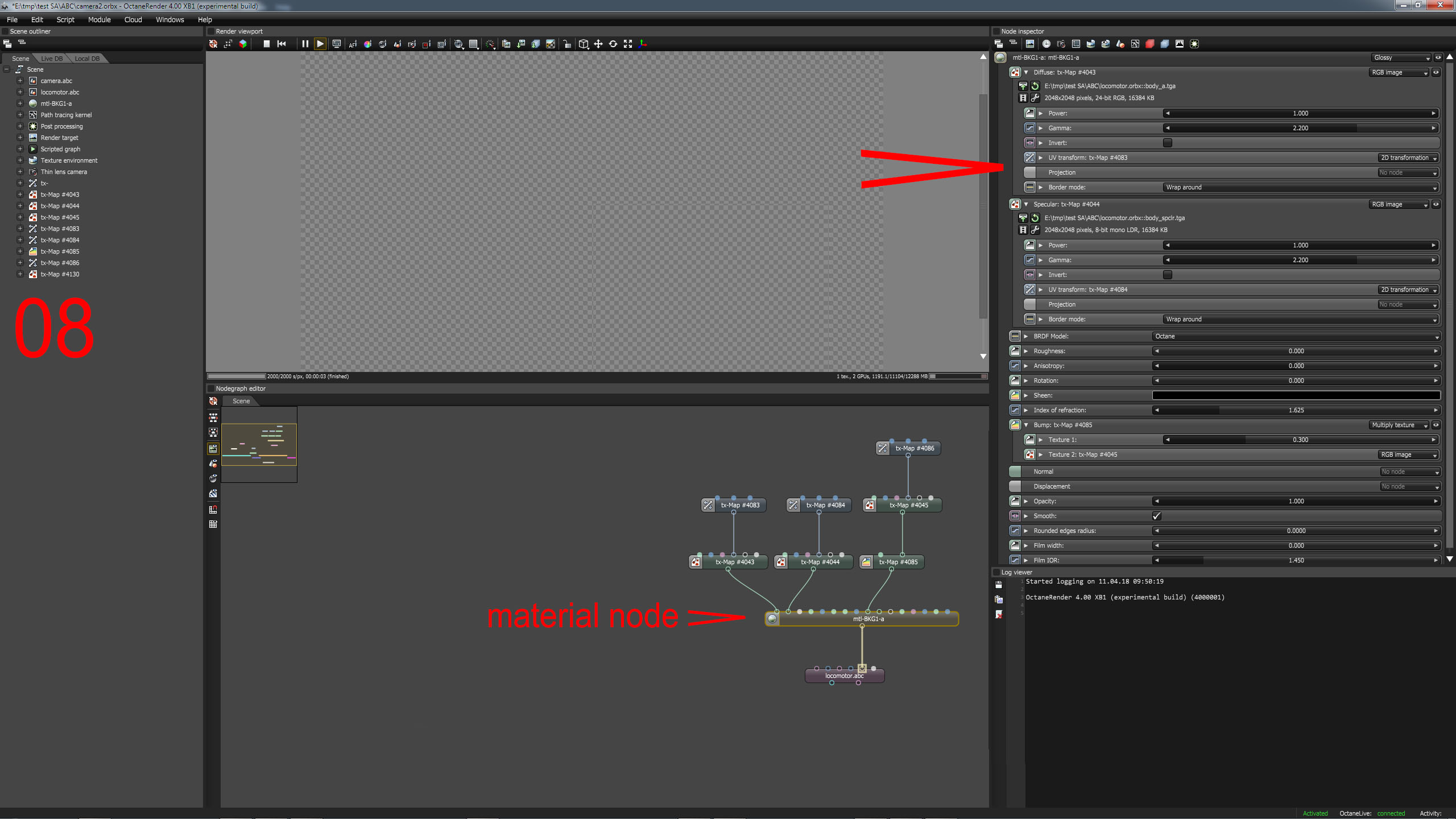

08 Octane shader node.

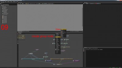

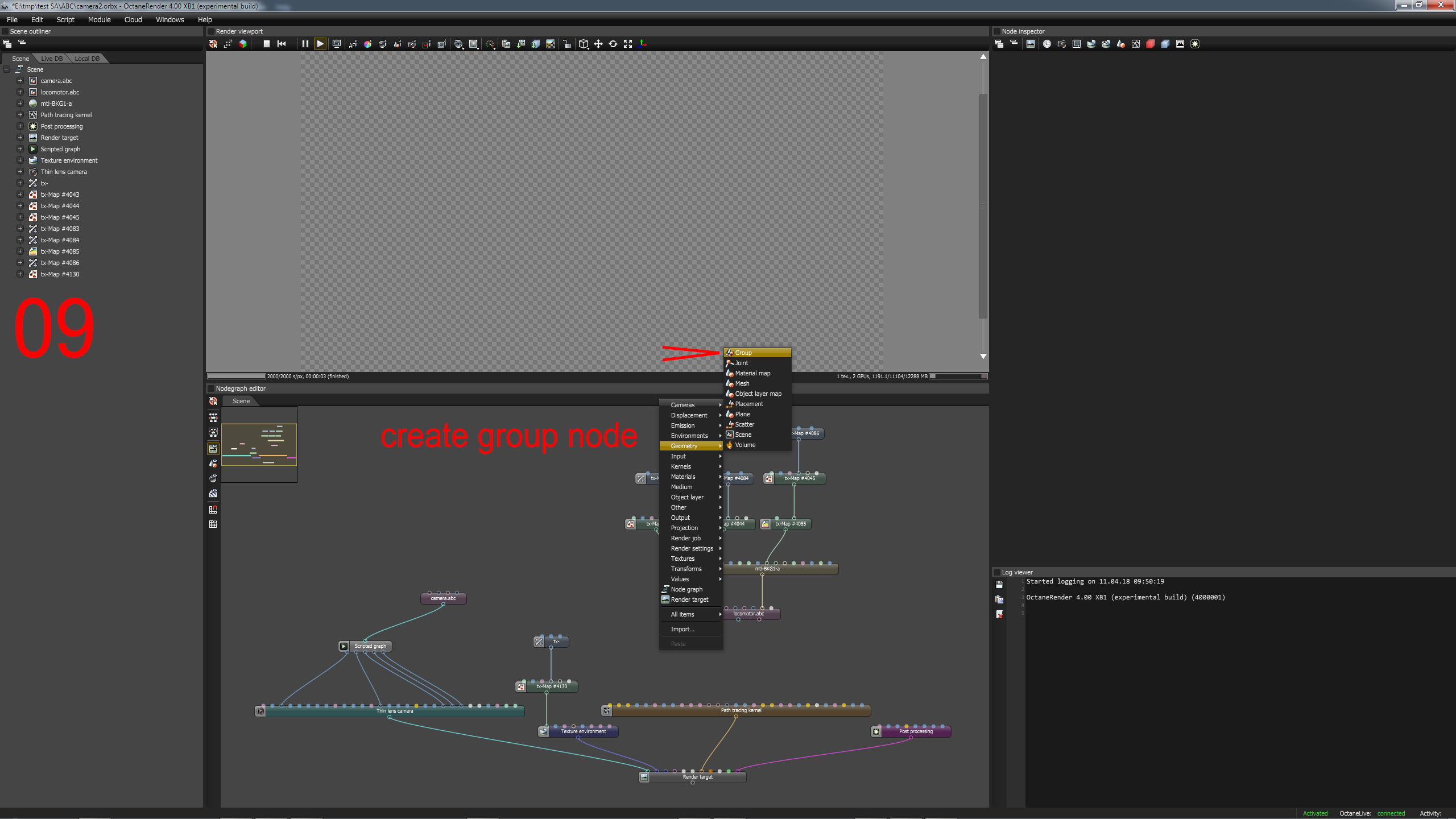

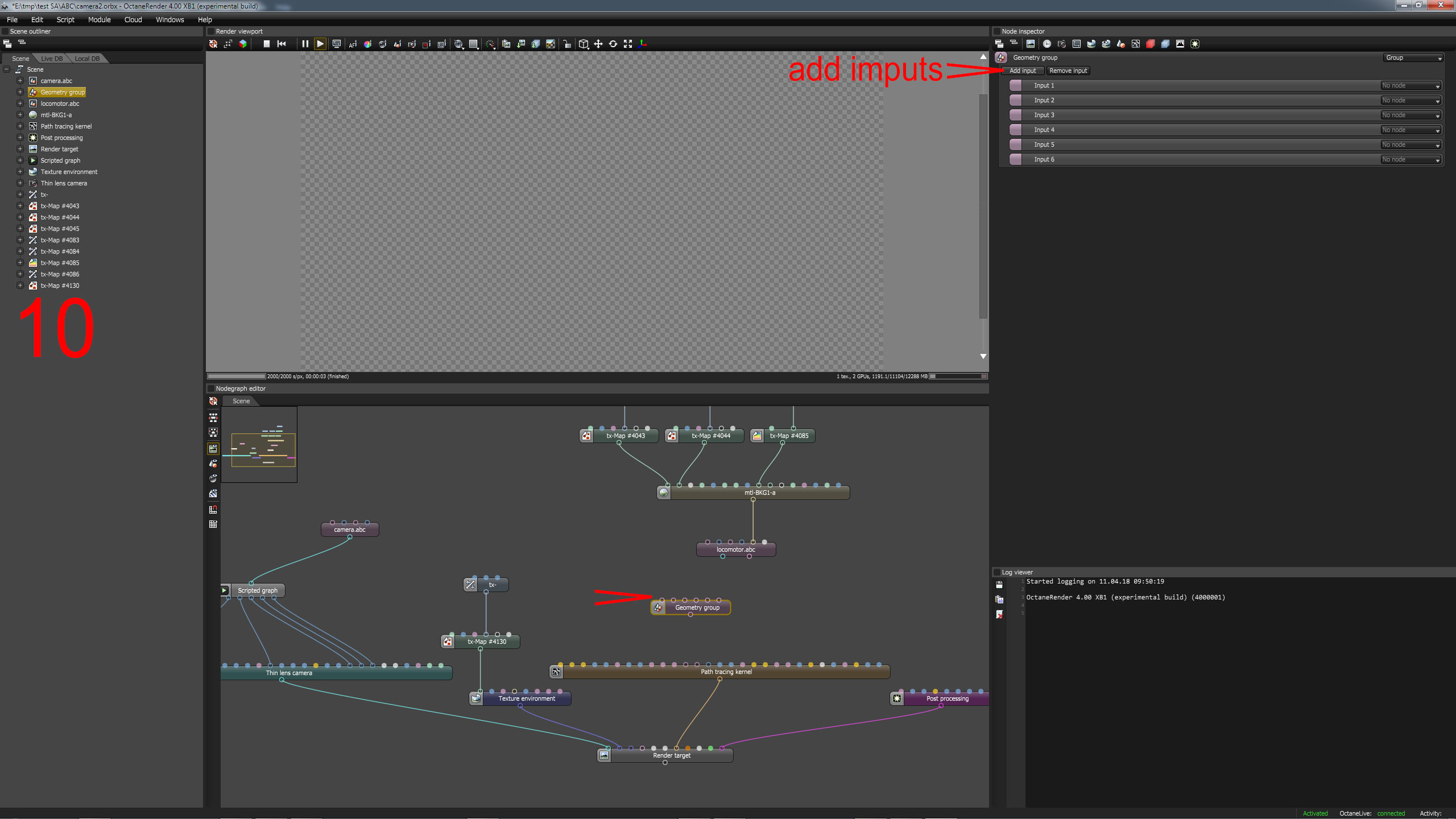

09 create geometry group (to connect all geometry exported to .orbx parts)
10 add pins necessary to connect all geometries

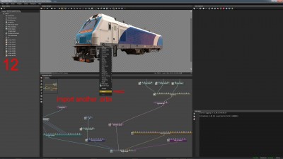

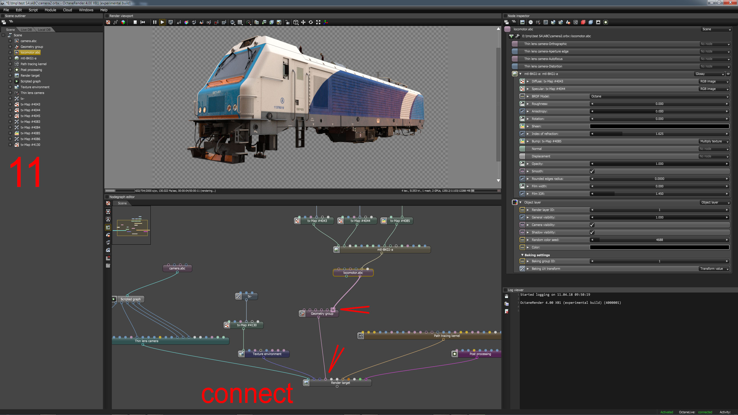

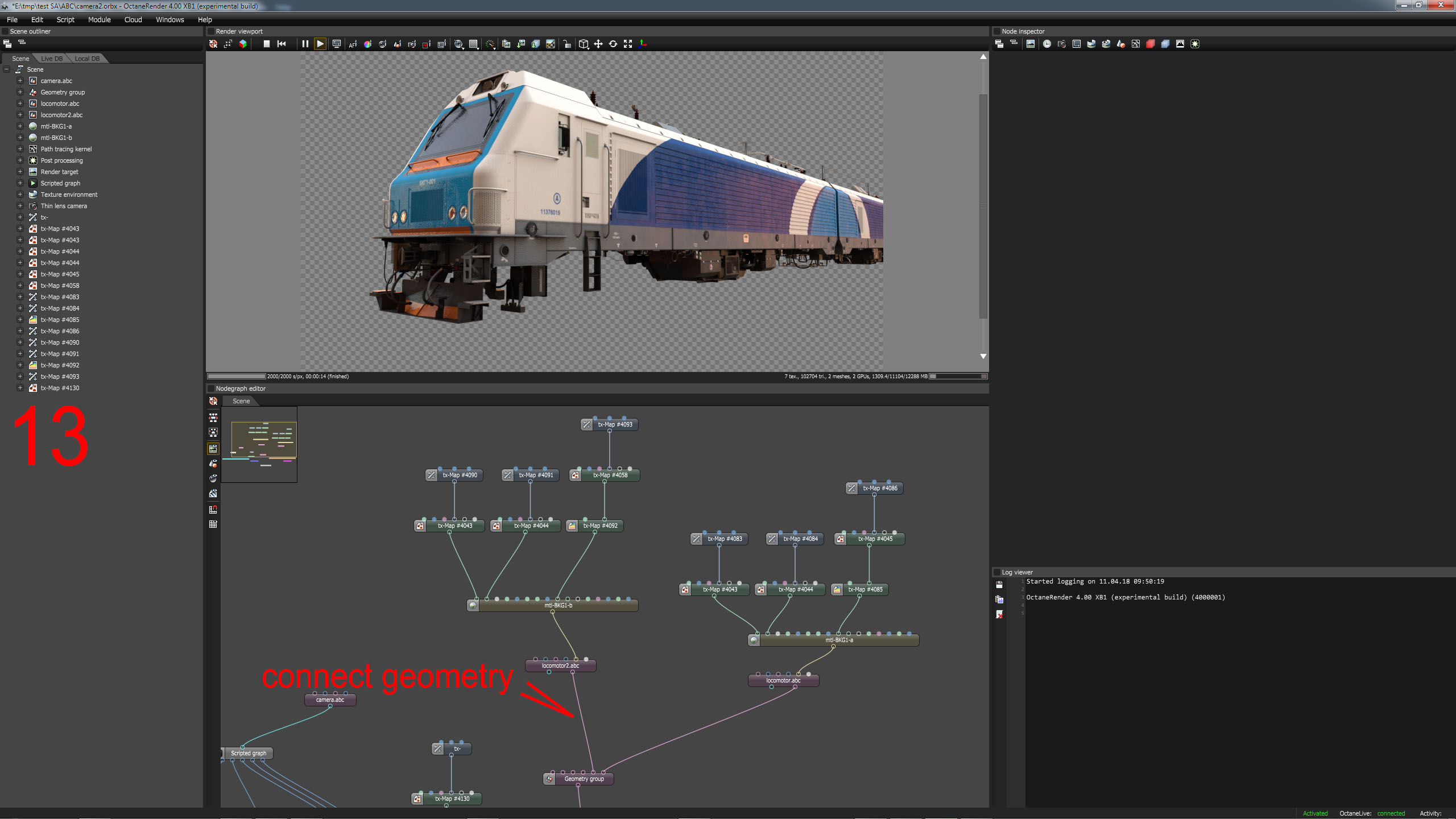

11 connecting geometry to geometry group and geometry group to render target

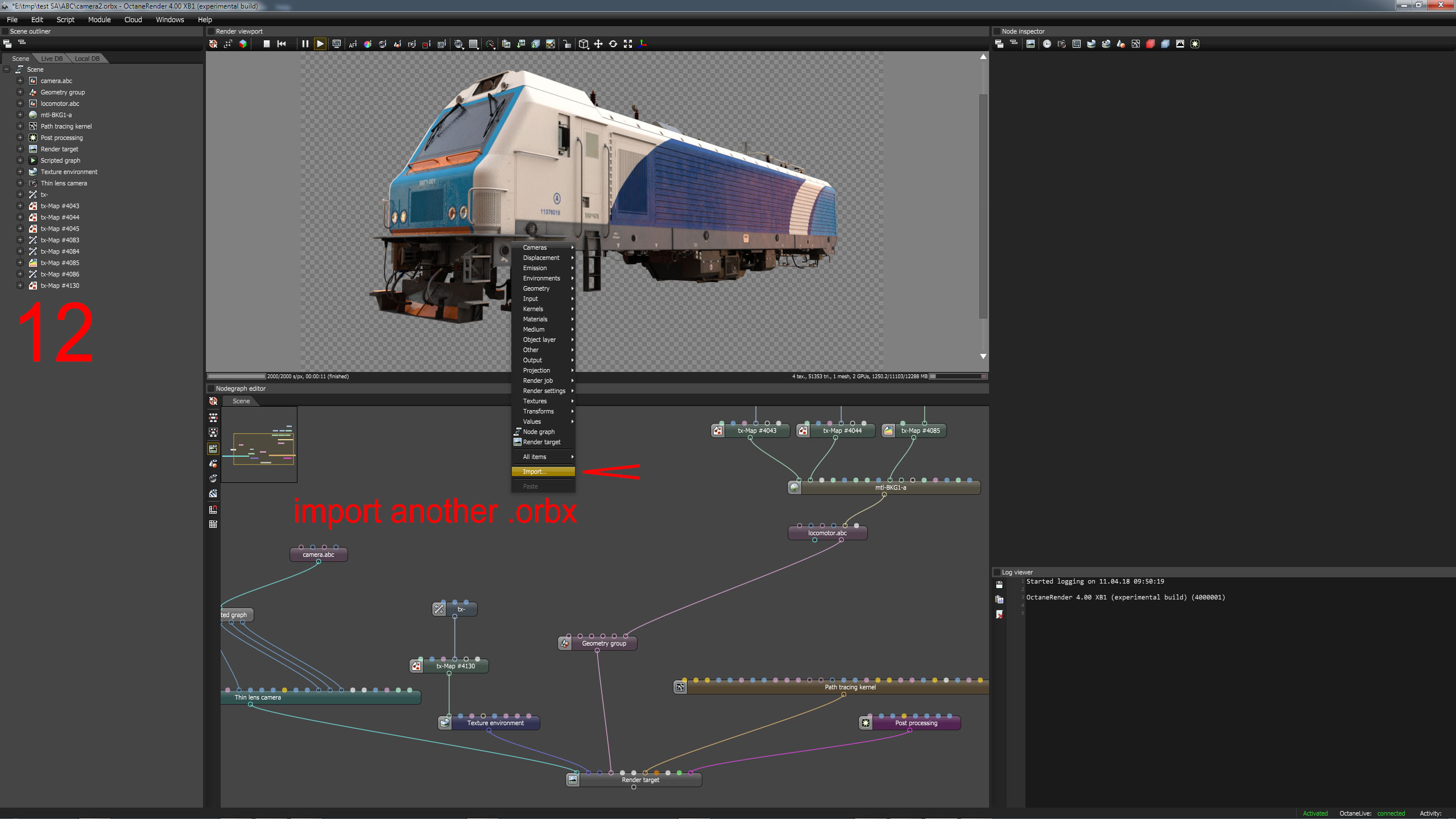

12-13 repeat 06 - 07

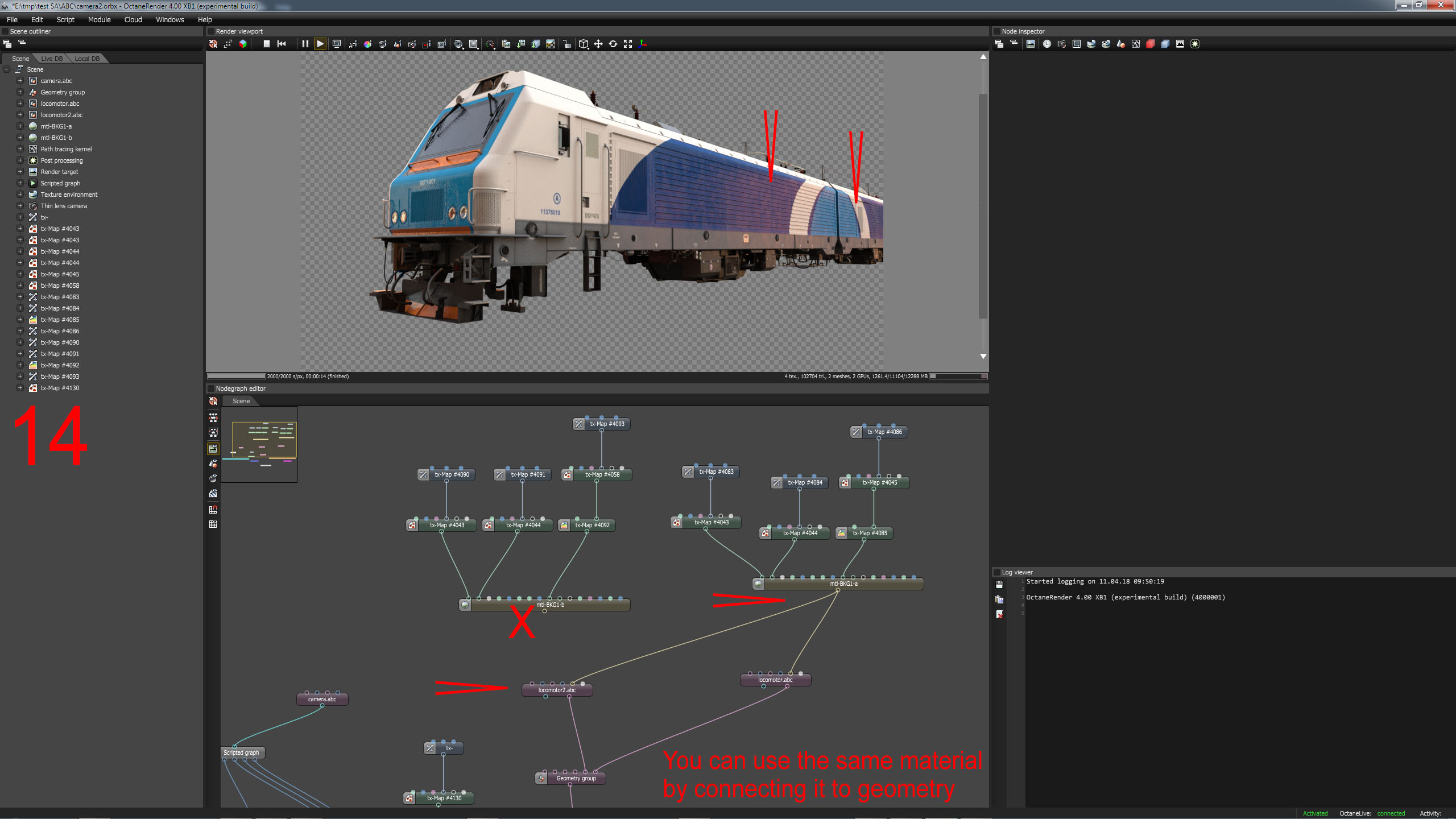

14 you can connect shaders to geometries you want

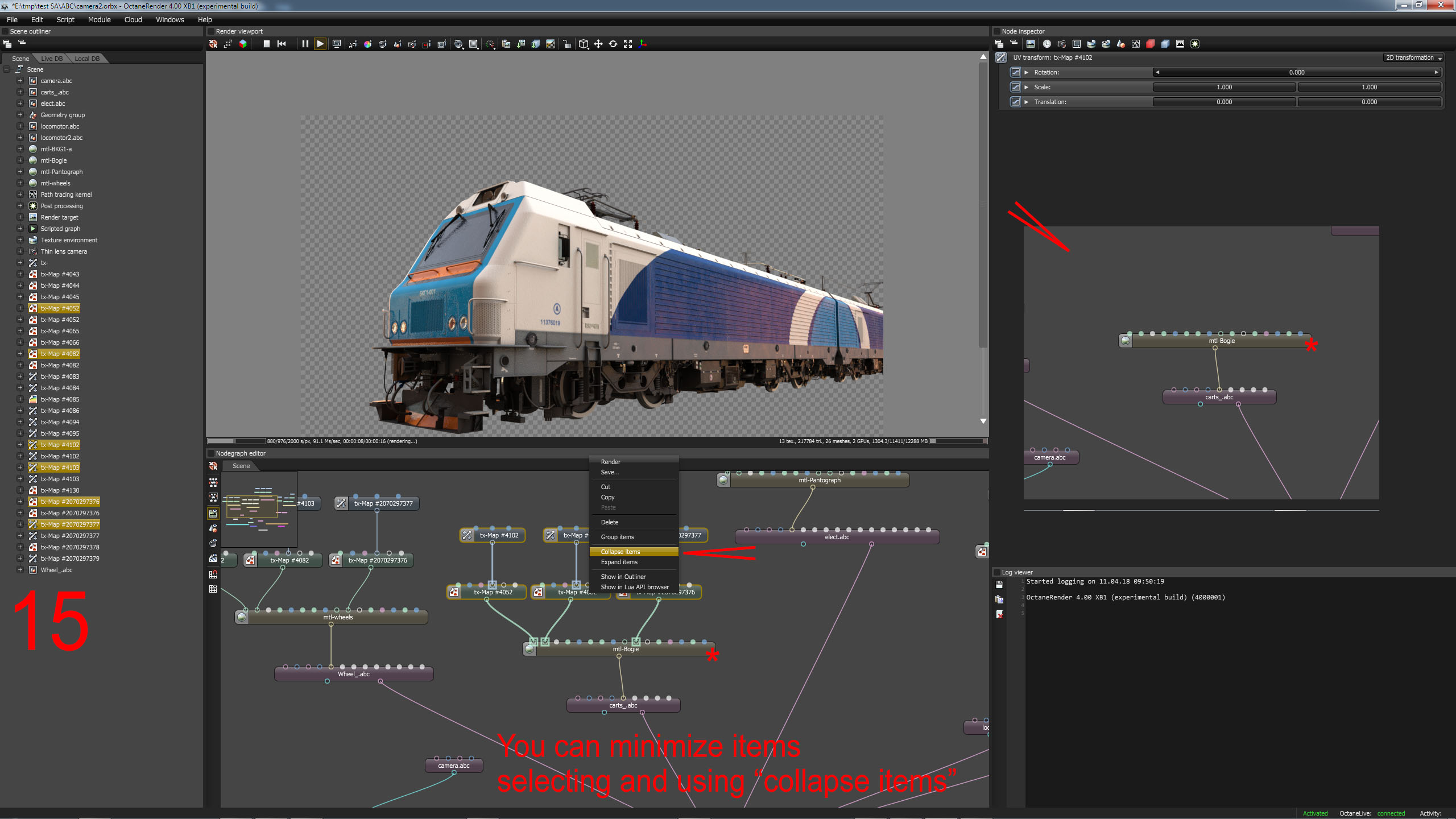

15 you can minimize pins if you wish.

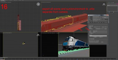

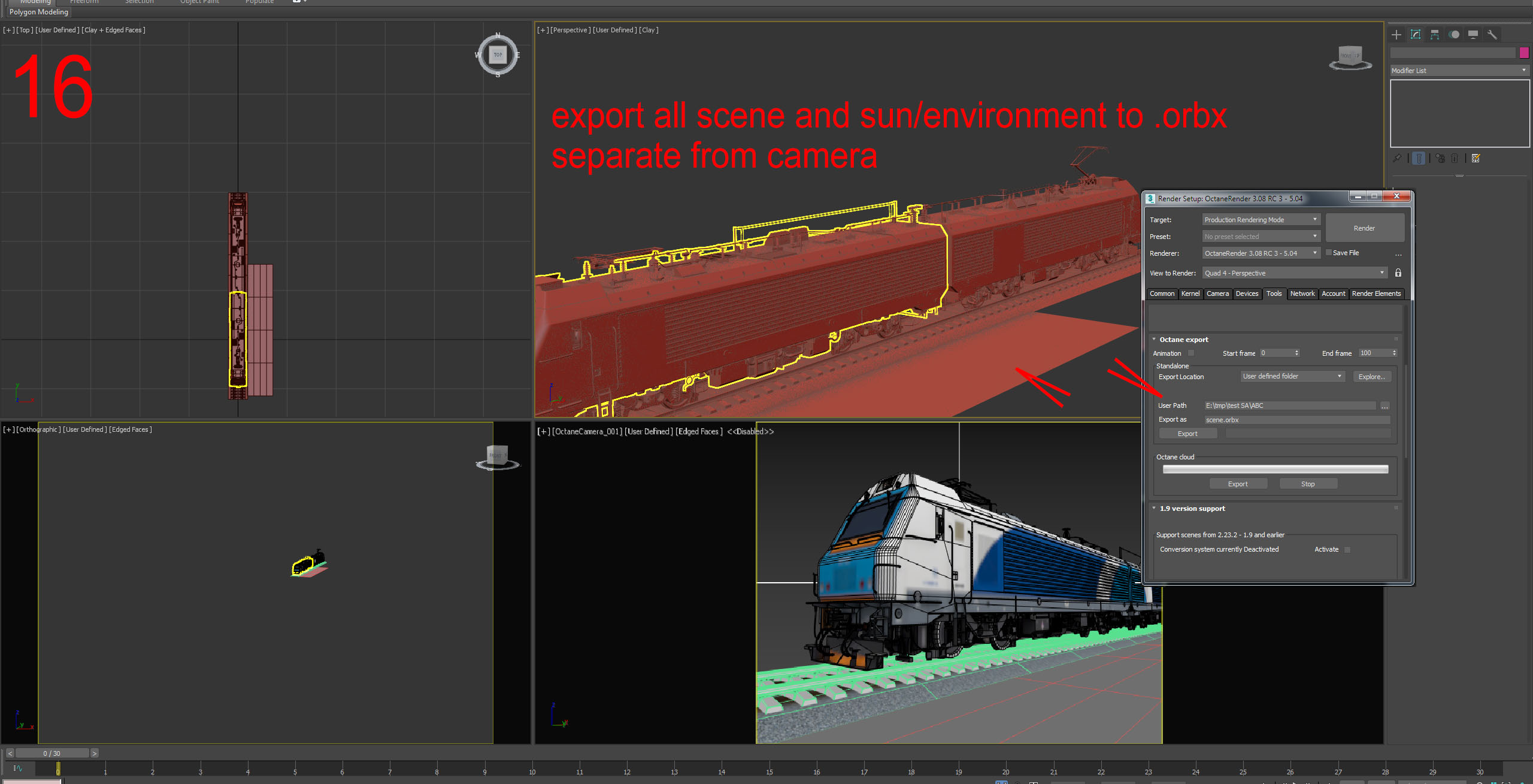

16 export all your scene and separate camera
