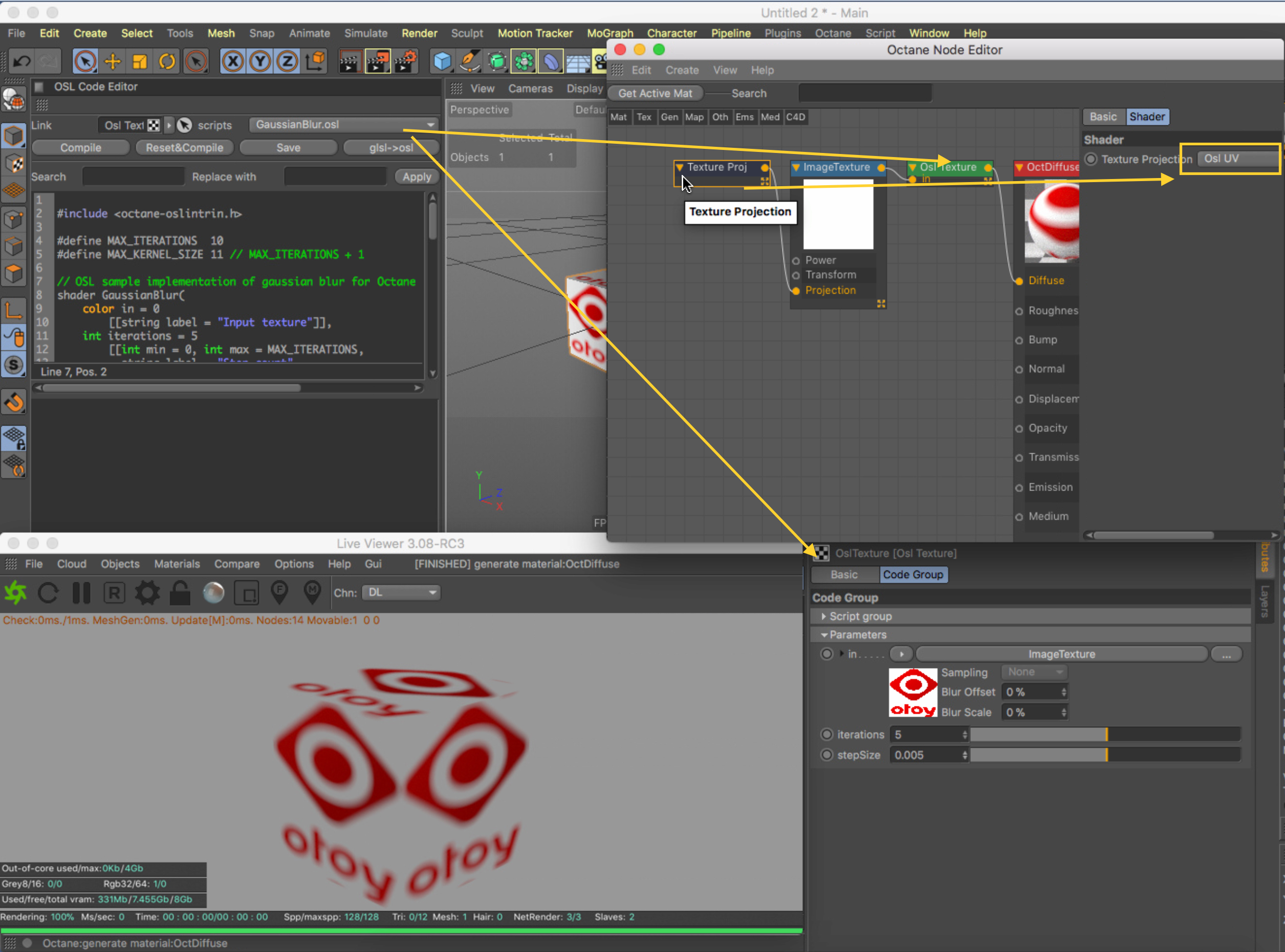

try with the OSL GaussianBlur texture node created by Mojave, you need to set the projection of the input texture as OSL UV, then plug the Texture in the input pin of the OSL texture node, load the GaussianBlur.osl script, and finally connect the OSL texture to the desired channel of the material:

This is the original link @mojave posted in the Facebook group (of which I am not a big fan). Make sure to set the projection of your texture to OSL UV for this to work.
https://gist.github.com/anonymous/18de5 ... 93eec13587
And here it is as .osl text file:

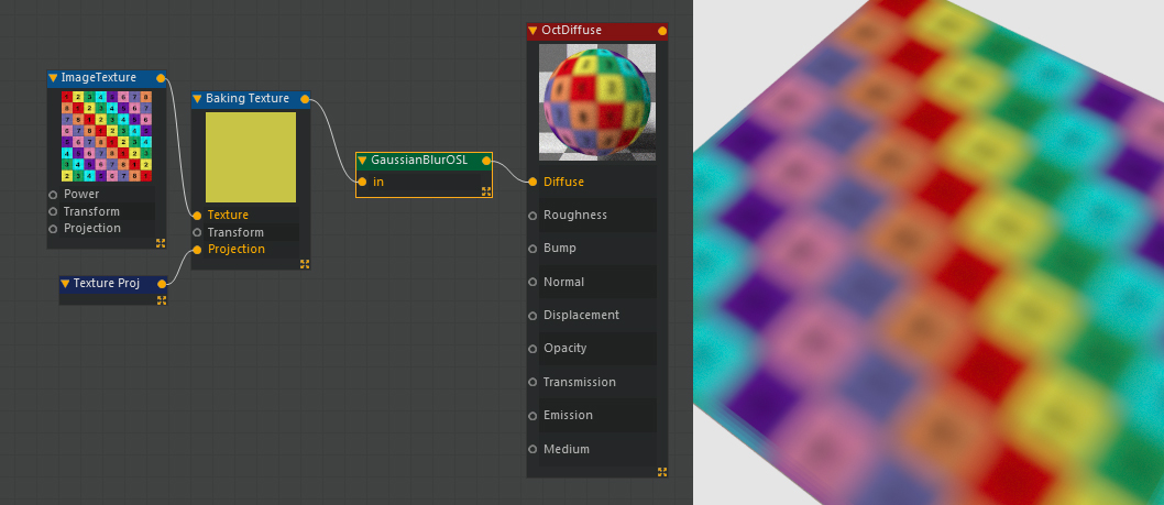

Posts: 261
Joined: Tue Apr 30, 2013 7:23 pm
It's hard to say, I guess it depends on the case. In my experience it works best if you keep stepSize to small values (low blurring amount). High iterations (Step count) improve the quality but slow down the rendering a lot. So, to avoid that, I like to lower the resolution by half or quarter using the baking texture node first and then feed that into the GaussianBlur node. That way I can keep Step count to a low number (faster to render) and also reduce the 'infinite sharpness' of procedurals a bit before blurring.
Baking+Gaussian.orbx
(409.97 KiB) Downloaded 378 times
Baking+Gaussian C4D.zip
(434.27 KiB) Downloaded 385 times
