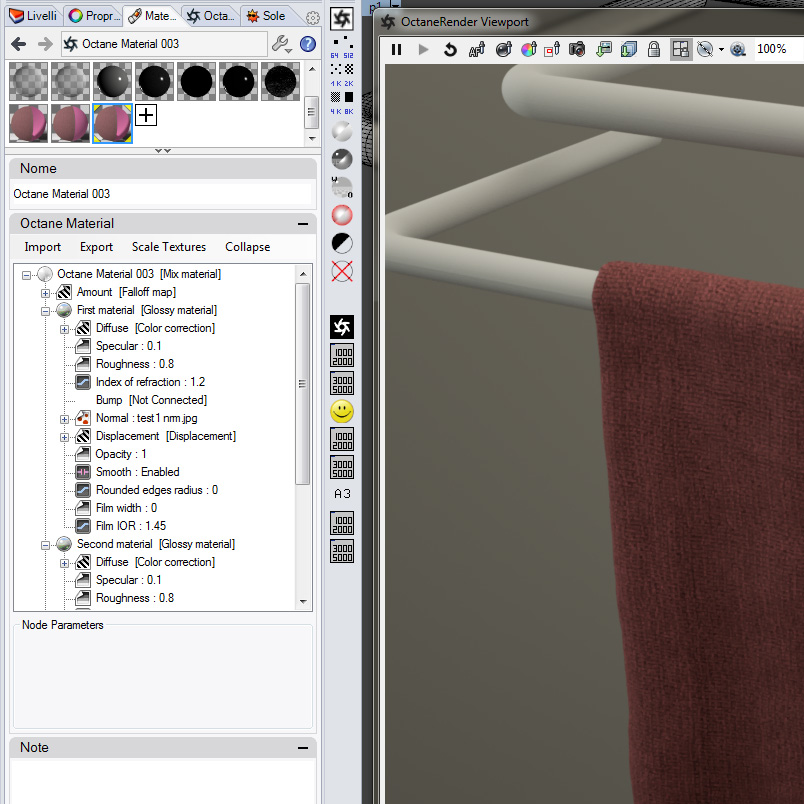

I tried to make a mix material with displacement but I can't achieve it.

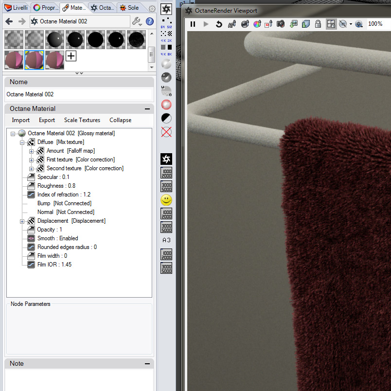

I I use a material with mix diffuse everything works fine.
Is it regular?

You need to set the displacement map in the Mix Material displacement pin, not the displacement pins of the First Material and Second Material pins.
