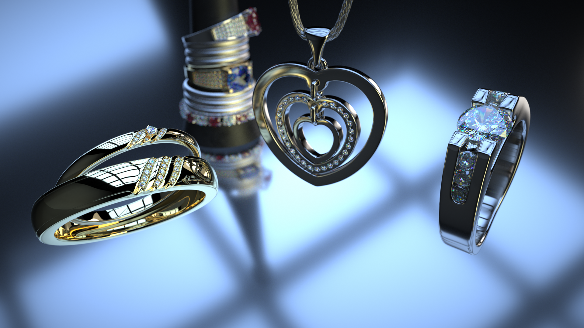

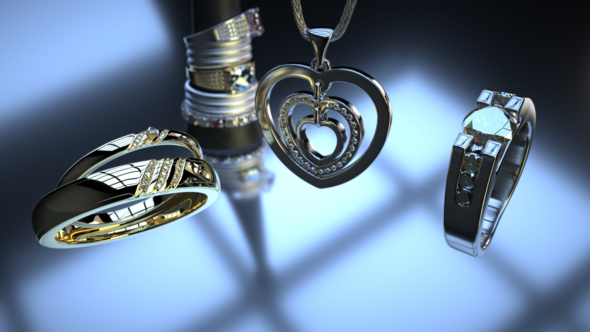

The second thing I noticed was how much better the specular materials look in Octane 4 vs LW. I'm not sure if this was something that was changed in Octane 4 or if its a difference in how something is handled in the LW plugin but it looks far better with the same settings. On a side note, denoise really didn't like this scene rendering out black pixelated squares around most but not all of the specular materials. It did still clean up the out of focus metal in the bg which was nice at least.
Specular material differences between LW and Native Octane

About the material changes, yes, I suppose that perhaps Octane 4 has improved materials not available yet in the current 3.08 plugins.
