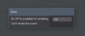

I am still trying to get LightWave 2018 working with the Octane_3.08.0.9
Now when I try to render or load IPR I see this:
What (the heck) is going on now??

maybe not updated to the latest CUDA, as required?

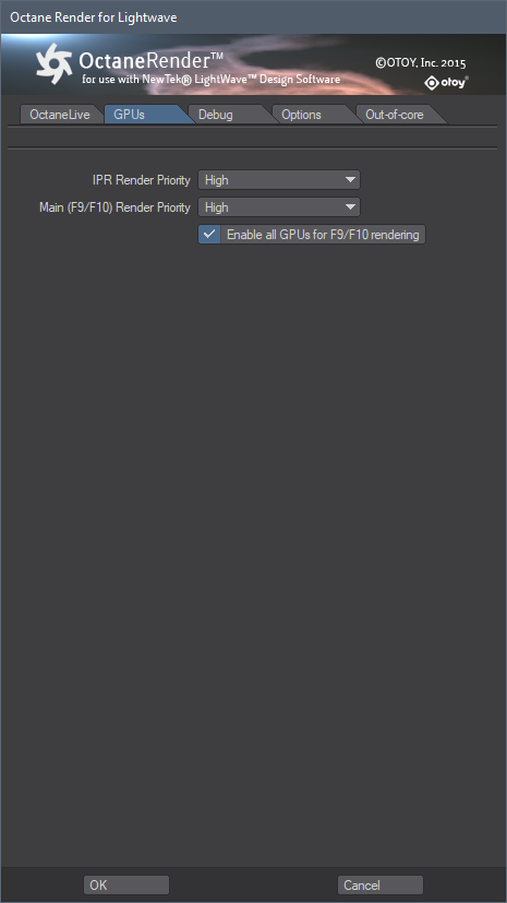

Yes, probably you need to update the NVIDIA drivers to the latest ones available. What do you get if you open the GPUs configuration in the plugin options panel? Can you see any GPU there?

lightvu
Posts: 94
Joined: Mon Nov 20, 2017 6:49 pm
juanjgon

Yes, the problem is probably that you don't have the right NVIDIA drivers on your system. Please, go to nvidia.com, download the latest drivers version for your GPU and install them.
