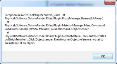

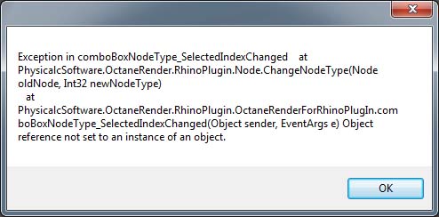

I have installed Rhino 6 with Octane 3.08.0.88 (Octane 3.07 standalone) and I am getting some intermittent errors when using the material editor.
Firstly the materials aren't displaying correctly in the material editor. The standard materials look fine but the Octane don't.
When I first open a scene I get the errors. Then some time later I don't. But the material preview still doesn't work?
The renderer seems to work fine if I open a scene and just render. But if I try and adjust a material or add a texture it gives me these errors.
I also had an error when trying to use the LiveDB.
Any ideas?

I could not reproduce this error. Can you pls provide an exact set of steps which will produce the exceptions you are getting?

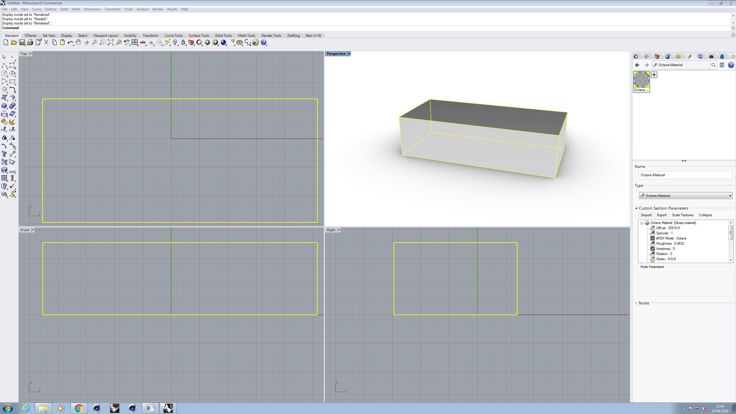

I'm too experiencing problems with Materials not showing properly in the Materials tab (no colour) and it the colour of the material showing in the rendered viewport
See attached

exact steps are....
I opened Rhino
set the renderer to Octane
created a cube
created an octane material changed the colour to red and it didn't show in the material preview window
I assigned the material to the cube and the colour didn't show in the rendered/shaded or ghosted viewport
However when I activate the Octane render window the it renders the correct colours
Also when we open Rhino 5/Octane files none of of the material preview colours show either??
I have downloaded the OctaneRenderForRhino6_3_08_0_89.rhi and this is still happening...
I have 5 users/machines and it's happening with all of them
Please help!
I did noticed the viewport lock works properly now so thanks for that..!

Thanks for providing those steps.
These issues appear to be a bug in Rhino6. I have contacted McNeel to help sort out a resolution.
I will report back here once I know more.
Paul
