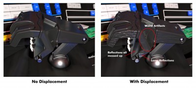

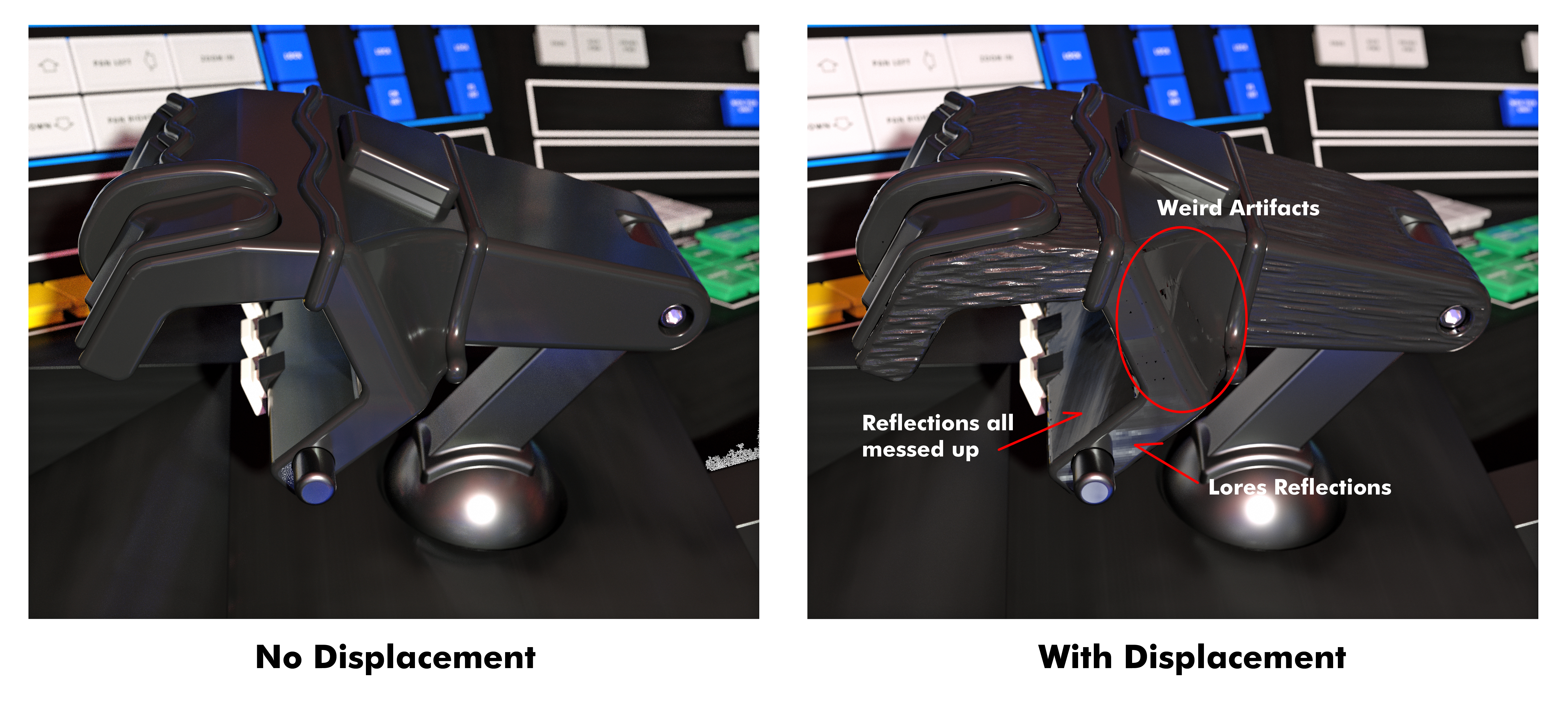

Hi all.
I have been trying to figure out what is going on here. Displacement is the culprit, but all that changing settings does, is move the problems to different areas, or change the reflections to some other weirded out look.
The desired displacement is correct, but the artifacts it causes in NON-displaced areas is the problem.

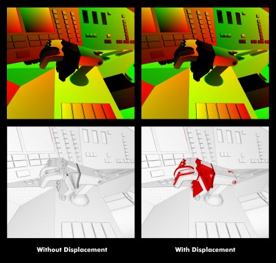

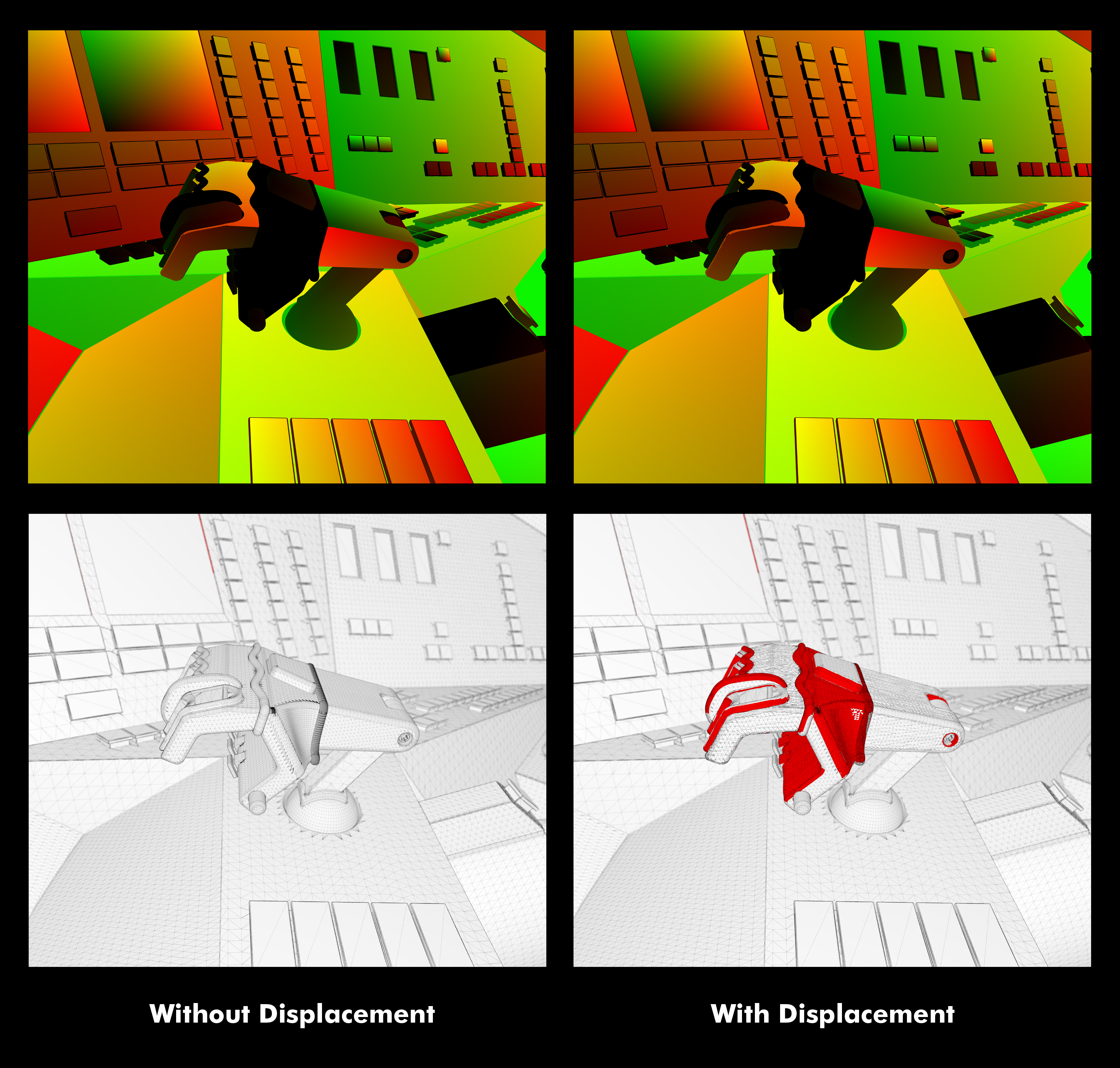

probably an issue with normals directions or uvs.
Please, change the kernel to InfoChannel, and post a screenshot in wireframe mode with Backface highlight option active, and the uv coordinate pass, thanks.

Here are the screenshots.
What is weird is that when displacement is added to the two parts (the only ones that have displacement), the button on top (in the middle) which is a completely different part gets screwed up too (it has no displacement).
Win7 | Geforce TitanX w/ 12Gb | Geforce GTX-560 w/ 2Gb | 6-Core 3.5GHz | 32Gb | Cinema4D w RipTide Importer and OctaneExporter Plugs.

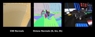

Thanks, Frank, for the info. It at least explains part of the improvement I see now that I moved those parts back into the 0-1 range, and painted with 50% gray. However, although the texture problems seem to have cleared up, the black triangles are still there and C4D says the normals are fine:
