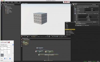

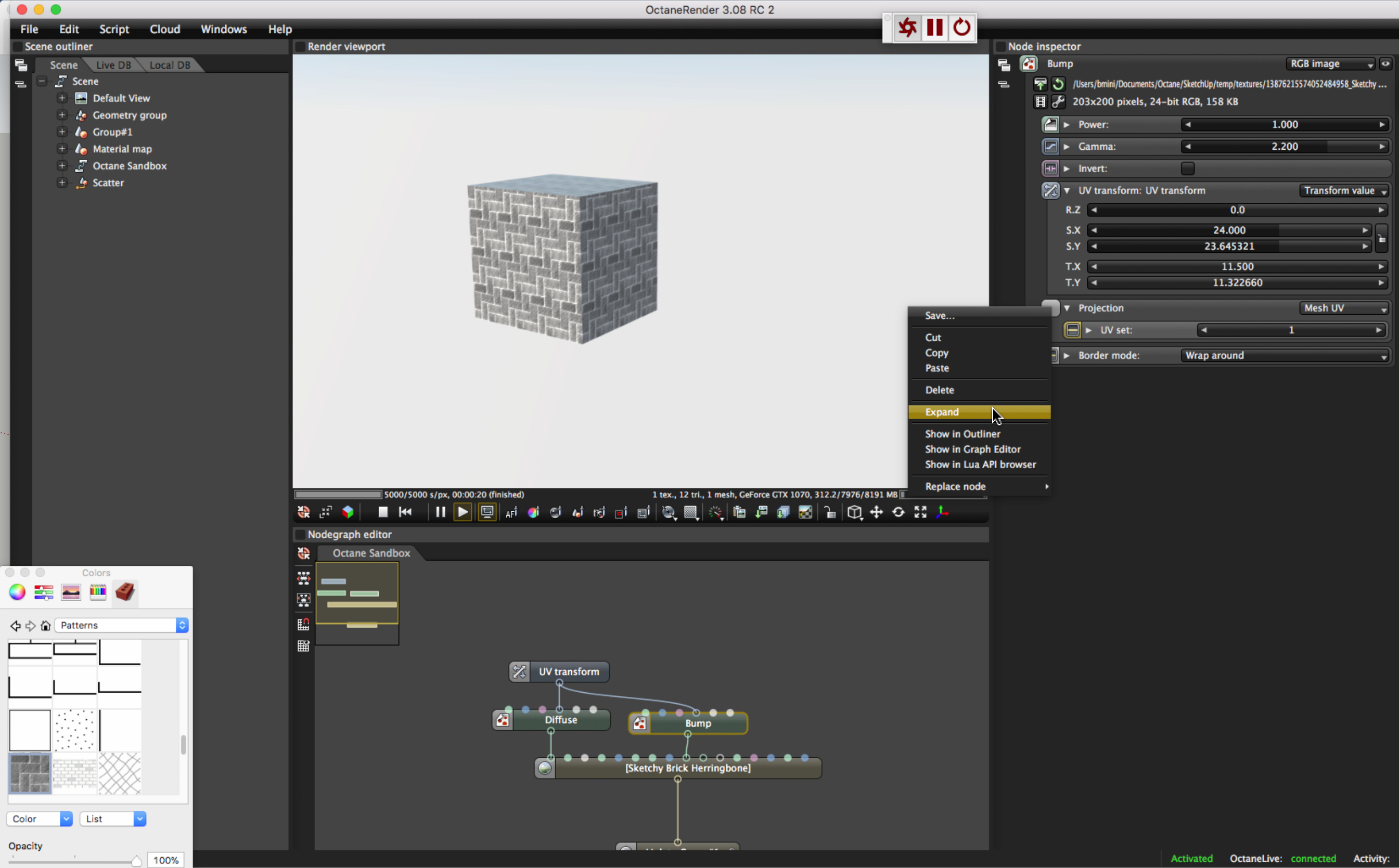

you don’t need to use a mix material for applying the bump map.
Just use the Expand command in the node inspector, firstly to the diffuse texture, than to the projection or uv transform node:
in this way you can share the same uv transform or projection node with different image maps.
ciao Beppe
