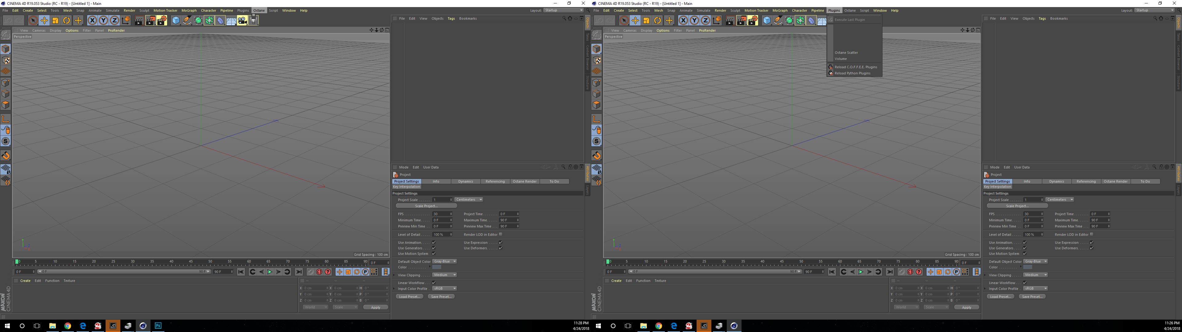

also if it helps, I can see it in the menu now, however it doesn't show anything under it when I click it, its just an empty menu,

yep everything is updated R19.053, drivers updated, internet connect. should all be good, but attached what I see. The login screen no longer shows up.
