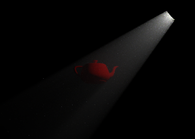

There are several topics in the forum related to the volumetric lights, even with example scenes:
viewtopic.php?f=36&t=59011&hilit=volumetric
viewtopic.php?f=36&t=53505&hilit=volumetric
Hope this helps,
-Juanjo
lightvu
Posts: 94
Joined: Mon Nov 20, 2017 6:49 pm
Thanks for those forum links!
I see how those were created, totally not what I was thinking, I thought it would be a light primitive but you are using mesh objects and the environment node.

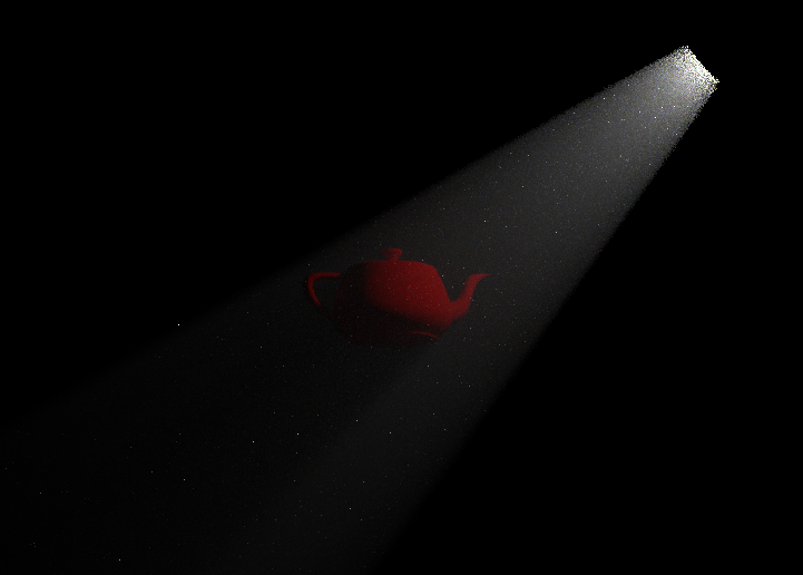

Quick question Juanjgon, which render kernel is best for volumetric lights? Which setting would increase the quality? I've tried 5000+ samples and to be honest it still looks extremely grainy.
3dreamstudios
Posts: 479
Joined: Fri Apr 03, 2015 8:55 pm
Yes noise is def an issue with this. (or at least always has been for me) As you can see even in that simple setup it had 8,000+ samples and was still grainy as heck. I don't have the time or resources to get my images on my 2 1080ti's to 8,000 samples. lol.
I have had to fall back and render out LW native volumetrics as a TGA and then composite in post. LW Native is super fast and somewhat decent for most things I need. You may consider that...maybe in V4 Octane we will have other options or noise cleanup..
